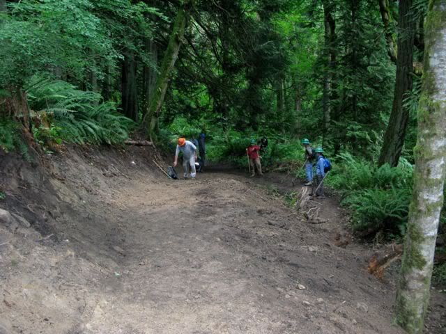

15 of us showed up on a cool humid morning. Worked on a reroute around a mud pit. The trail used an old logging road that has become worse over the past few years. The next phase will be building retaining walls around 2 trees. Also beat back some brush and improved some drains. Only sow 1 runner and 3 riders. Took a bike for a test ride to check my drain dips. New trail seem kind of wide but give it a few years of plant growth and it will be just about right. Next work party 7/25 Big thanks to 2 other riders that showed up.

Dave, a nice touch I always use when digging outslope like that is to revegetate the lower side with ferns that were dug out to re-establish the line and make it look less offensive on the eyeys right away. Throw some random sticks, leaves, etc on the open soil as well to help retain it and "hide" the recent work. Even just a few ferns up on the outer lip of the trail will help keep people up on the solid bench work. Also nice to see a good inslope above instead of the 90 degree chopped in look.

I'm sure the old trail will be obliterated when the time comes.
