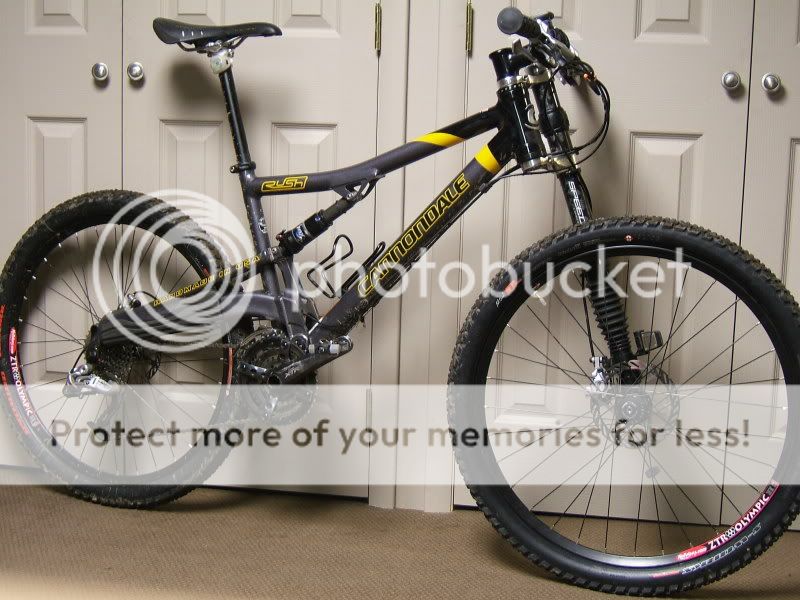

The Olympic is a great rim, with a Specialized Captain S-Works 2Bliss I run 25 psi no problem. Never burped a single psi. I have tried to roll a tire to burp in turns, and on rocks and have failed...with 4 tires. The Maxxis Crossmark 2.1, the Maxxis Larsen TT, the Captain sworks, and the captain control...never burped or flatted. On all the tires I have run, I think they run stiffer than a tubed tire, no wiggling at all. I built these as a wheelset to be light, tough enough to be a primary wheelset, and get into racing. I've done a few team 24 hr races, and the rims are fabulous. This wheelset has become my primary and only wheeset, as I sold the stock xm117 with lefty and shimano m475 hubs. I am yet to find a problem with this rim.
The thing about I9 is that some of them are light, and they are a great wheel, but their price is astronomical. An I9 wheelset that would match my Olympic in weight is like $800 dollars....But if its color you want, I9 is the way to go.
Keep in mind there are two Olympic rims...the 347g which is guarenteed under 352g but the recent batch is ranging from 330g to 340g. The other is slightly heavier at around 350g-360g. The under 347 is $85, and the heavier is $75...I'd say its worth the extra $20.
Here ya go!
amillmtb - your bike looks great. It is now clear to me that Santa is going to bring me a notubes olympic wheelset. I don't expect to be much faster but surely I will notice some different handling characteristics right? I guess since I'm about to throw money down on these I want to hear someone tell me that there is a big difference! ;) I'll post up a picture of my bike once I get them switched over. Thanks again for the info.
