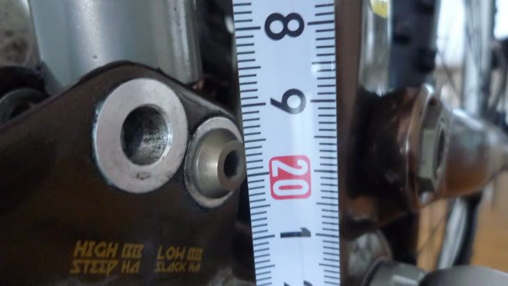

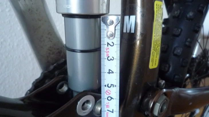

This is what I measure on my bike:

My shock is: Eye to eye:198.0mm (7.8") Shock Stroke 53.0mm (2.09")
The shock is not compressed in any way! What gives? Why is my shock so small? Is the shock faulty? Can someone help me out? :skep: :confused: :mad:

Sounds like air has bypassed the seal into the negative chamber. Try rebuilding with a new air sleeve kit.

Some of the early manuals had a misprint, the AFR Enduro shock has an eye to eye of 200mm +/- 2mm
1,706 Posts
Discussion Starter · #7 ·
Oh ok, so my shock is actually pretty much within the limits then. Didnt know about the misprints.
