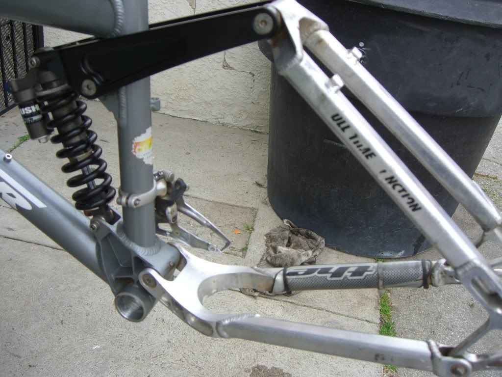

2001??? That's my guess. This medium frame was owned by Maxine Irving, and possibly raced during the 1967 season. It's been sitting in my friend's garage for the past 5-6 years, ridden once a year.
My pro photog skills at work here, focused on the rag...
I thought the brake adapter was a particularly interesting piece...
So for the purposes of selling this thing, it's safe to say that travel on this is 6 inches? It's got an early vintage PUSH'd Vanilla RC with the race tune. Classic stuff. :thumbsup:

I'd say 2001 also. A friend had a small '01 with the same ht/dt junction gussets and bolt on rear brake mount. Looks like the steeper rockers too. Nice frame.

There's a few interesting things to note about this frame.
The head tube without the ridge at the bottom suggests 2001/02, but there are no ISCG tabs on the frame which you'd expect a 2001/02 frame to have.
The machining of chain stay link where it bolts to the frame also looks like a 5 Spot/XCE item and not a RFX version, so I'd say someone in the past has experimented with the suspension setup.

Good points here. This is why I wonder about final travel on this frame. My friend has owned the frame for about 7 years and never modified anything, but Maxine may have done some tweaking if she(possibly) raced on this bike.
I'm also curious why the brake mounts were made modular since there are no canti tabs.

Definitely an '01, ISCG tabs were on the '02 as well as a thicker head tube (DHR). 01 has the bolt on rear brake adapter as well. Chain stay machining matches the vintage as well.
Travel on the frame depended on the rockers you had, there were 3 in all, a 5" rocker and 2x6" rockers which varied the geo.
If the shock is the original 7.5x2 size then it's 6" of travel, and those rockers look to me to offer a lower BB then the alternate version (can't remember right now which one was labelled A or B) as I'm using them now on my setup.
The alternate rocker raised up the BB and could give more travel (6.75") if you used a 2.25 stroke shock. This seemed to work best with a longer travel fork but I never liked the taller BB.
Canti's were a clamp on option at the time but I never ordered a set.

Bought my XCE new in '03 (correction '02 - just checked the receipt) with the same brake adapter. A friend bought an XCE 6 months later and the tabs were welded in place.

Great info. The spring on the shock is a 2.25"(pic above) but I guess I'd need to measure the shock shaft to be sure.
So are you saying the rockers are actually labeled? Where should I look?

Not 5" rockers based on the pics of my old 6 Pack. Those look like "B" rockers if you look at picks from the Rocker thread. The cut-out goes over the pivot bolt which = 6" B rocker.
Rocker mounted is the 5" RFX rocker. It has a much longer cut-out section than what's on your bike.

Could also be either 00' or 01'.
Frame looks a lot like mine and I was told it was a 00'.
