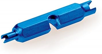

You will need a valve core remover:

I was able to do add the sealant without a core remover and just carefully used pliers to remove the core.
You got away with it this time, but a proper valve core remover is so much easier and less likely to trash the valve core. I have a valve cap that also fits the core, so I'm never without one.
I have a cap that looks like it should fit the core, however I could not figure it out. I will definitely buy a proper tool next time, or use the cap if I can.
Just to be clear there are 2 types of valves Presta (are far as I know only used on bikes) and Schrader every where else plus bike. Schrader valves need a valve core removal tool, Presta's you can remove with needle nose pliers.
