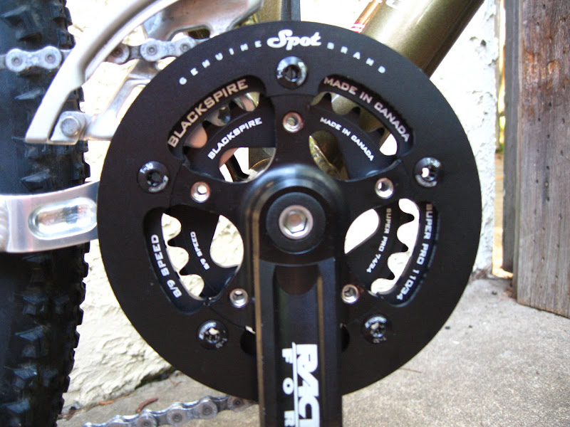

568 Posts
411 on BCD
2. Take your chainring and measure (in millimeters) the distance between two bolt circles. Make sure to measure center to center from the two bolt circles. Mountain bike applications usually are 104 mm BCD.

Expert Crasher
6,359 Posts
Most rings will be stamped w/ the bcd and tooth count (look lower right approx. the 4 o'clock position on my chainrings)
