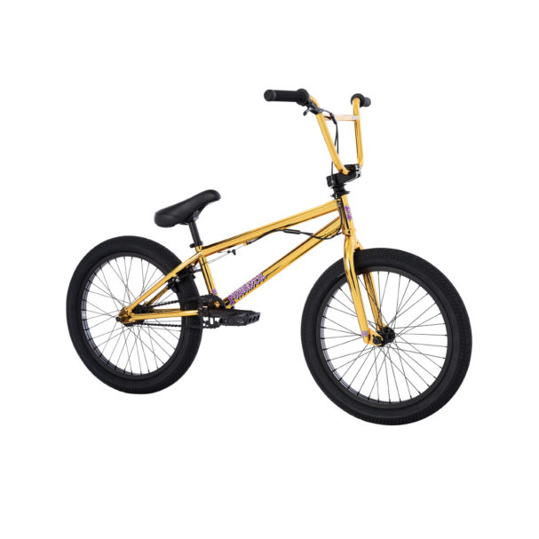

This is a super dope 20" top-tube bike from Fit (my fav BMX company). Its not cheap at 550$...he better be able to slay a bit if he gets that flashy gold :).
