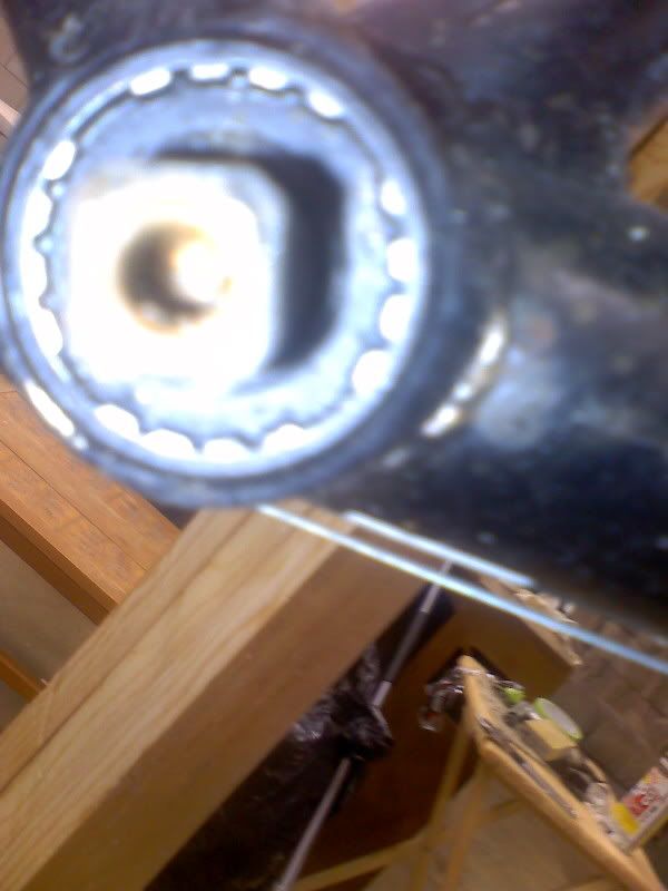

I am rebuilding my Girlfriends Mongoose, but I am stuck with out the too to remove the BB. So what do I need?
1 - 20 of 32 Posts
Crappy picture (use a macro setting and/or move a few cm further away), but it looks like a Shimano/ISIS interface. You need a tool like this one, just make sure that you get one with a suitable drive interface (1/4" or 1/2" socket and/or spanner fitting) for whatever drives you have in your toolbox.
Yeah sorry about the quality, its actually my cell phone.
Sure looks like the Shimano/ISIS interface, altho I've not seen one with the four gaps between series of teeth like that appears to have.

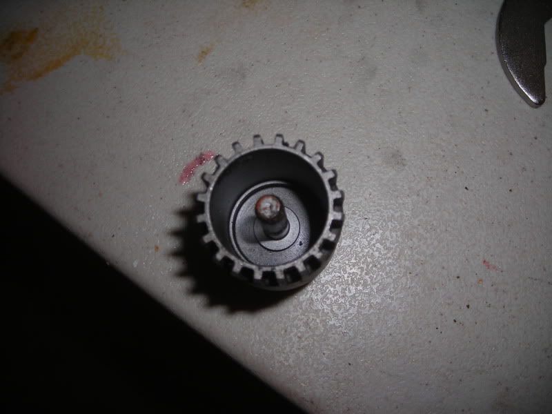

Here are better images. I actually have the Shimano/ISIS tool and it does not fit. It needs to be a tad longer to allow for the axle sticking out and there are way too many teeth.
Looks like it's a 20 tooth interface like the Shimano/ISIS tool you've got (at least accounting for the gaps that's what I counted), but you've got that goofy projection inside your bb tool, try the Park BBT-22, doesn't have that projection.
I think its Park bb18 or eq. but I'm not 100 % positive .
This is BB18
Looking at my Park Book there is nothing in it that looks like it exactly.
Yeah , I got nothing other than trying an adjustable pin spanner . Someone knows what it is , maybe try posting in the Mongoose forum .
I was looking at your first picture for the tooth count, seems like the 20 tooth tool should work. No way that's the BBT-8/BBT-18 interface, though. Your new photo isn't much better, but does look kinda lik the teeth don't line up now that I peer at it some. Maybe some proprietary thing Mongoose used if the 20-tooth tool doesn't mesh even without the projection...any Walmart mechanics out there? :D (altho thinking about that, they probably install that at the factory).

I thought about drilling out the back of the tool I have and see if it holds up. If I have to buy a whole new tool any ways, I mine as well try and get the one I have to work.
Your tool may be hardened , if it is its going to be extremely difficult to drill .

Not a problem if I can find the right bit. I have actually drilled through 5160 carbon steel 7.5mm thick :thumbsup: Doesnt sound like a lot but when it is hardened it takes a while.
