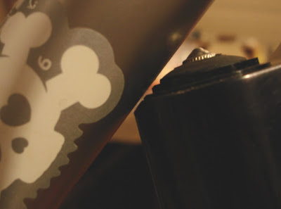

I mounted up a WB Fluid 135 on my MOOTS last week. The WB manual gives all the info on how to tune it, but no suggestions on where to start. I'm not gonna get a whole lotta riding in on this bike, so I don't wanna waste a lot of time fiddling with the adjustments.
For my first ride I went out with the booster spring removed, a low amount of preload, and towards the lower range of compression damping (@10PSI). After riding it a little bit I added a lot of preload as I was blowing through the travel too quickly.
Went home, reinstalled the booster spring, removed most of the preload, and lowered the compression damping to almost nil (fork did not seem active enough on low speed hits). Am I getting close here? Rider weight 135lbs dripping wet and mostly nude.

Hi,
The WB is very linear, but a nice fork.
tune it in order,
first thing first get the spring correct.
Do you have spring stacks in both legs or just one?
Also if you are having small bump sensitivity problems, popping the constriction springs off the wipers helps lubrication.
Don't use any compression dampening, try running the chamber at negative pressure.
This will greatly increase small bump sens, but make you blow through travel faster.
Good advice.
If there are springs on the right (damper) side, remove them.
If you have any air pressure at all on the damper side, empty it. Even better, push the valve in and compress the fork, release the valve before letting it up to get "negative" pressure. you could do the same on the left side also if you have an air valve there.
Final fix is to get a softer spring stack from WB for the left side.

I'm gonna try the negative air pressure (or none at all). That might be what I'm looking for... of course the manual says 0-50 PSI and nothing about negative anything PSI. That's what you e-experts are good for.

Or you could get on the phone and call WB directly. They are very helpful and I am sure they have set these up for 130lb riders like yourself before.
BTW, the negative air suggestion came from them originally.

Just did the negative air pressure thing. Feels better (in bike room squish tests). Maybe I'll get a chance to ride it this weekend and find out for sure.
