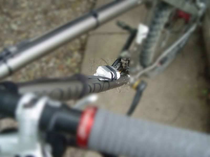

Waterbottle mount battery holder:
I just bent this aluminum strap into a rectangle and drilled a couple holes. Fits right on the bottle bosses and will hold this LiMnNi fatty pack nice'n'tight. I desoldered this pack to put a longer cord on it since it's gonna be my bar mount pack. I'll plasti-dip it tonight after my ride.

252 Posts
I've had pretty good luck with an L shaped bracket made from 1 inch by 1/16 aluminum flat stock. Put a 1/2 to 1 inch bottom on the L. The stuff is easy to bend by hand in a decent vise.
Drill two holes for bolting it to the water bottle mounts. You can countersink them if you want a flat surface. I just use regular bottle bracket bolts and let them stick out a bit.
The above works really well with my 9.6V 5AH NiMh battery (8 cells stacked 4 on a side) and would probably work pretty well with 4 Li-Ion 18650s stacked 2 on a side, or a dual cell battery like yours. Sit the battery on the bottom leg of the L, and wrap a nice velcro strap around the battery, bracket, and whichever bike tube you mount the bracket on. I like the seat tube, 'cause I run a wire to my home-made tail-light and another to the headlight.
I usually get away with a single 1 inch wide velcro cinch strap, but you could use 2 if you plan on jumping off boulders in the dark :)
Your holder looks pretty solid. I'd still consider using a velcro strap to make sure the battery doesn't fall out the side (it looked like you used one in the initial picture).
The big advantage to the L design is you can use a bunch of different battery types without having to change the bracket.
Mark
2,707 Posts
Discussion Starter · #9 ·
Mark
Re: velcro...
This pack isn't going anywhere.:thumbsup:
I used it initially b/c the pack was shrink wrapped and slick. Now that it's got a cushiony tacky rubber coating...it's 100% static.
2,707 Posts
Discussion Starter · #11 ·
You guys don't seem to understand. The battery doesn't slip in and out of the holder. I have to remove one mount screw and hold it out to get the battery in and out. The part where the holder goes around the pack is slightly concave/recessed, so when the thing is clamped down...I can't budge it with my hands at all. No strap needed.

2,707 Posts
Discussion Starter · #16 ·
Well I don't know if you can see it, but there are two screws holding the mount on. One is a flat head screw that sits flush...the other is on the outside. The mount doesn't even touch the frame. See the closeup? It is a few thousanths off the frame and sits against the bottle bosses.
No chatter, no rattle. I can't handle that noisy crap.
Very quiet and simple.
