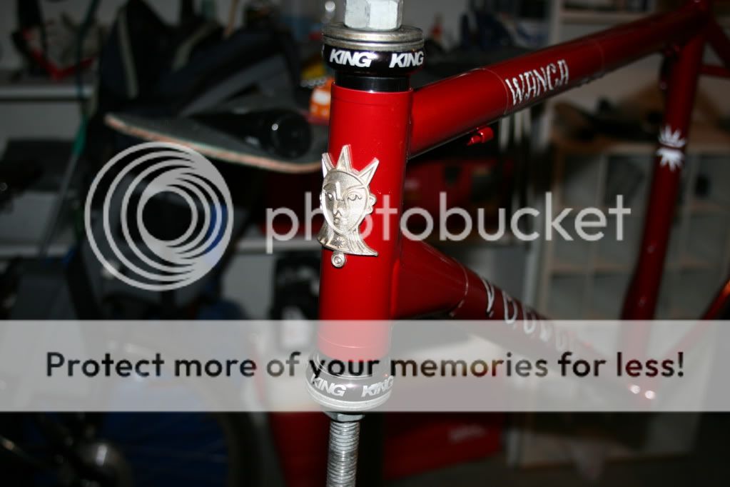

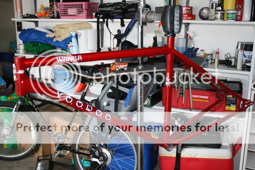

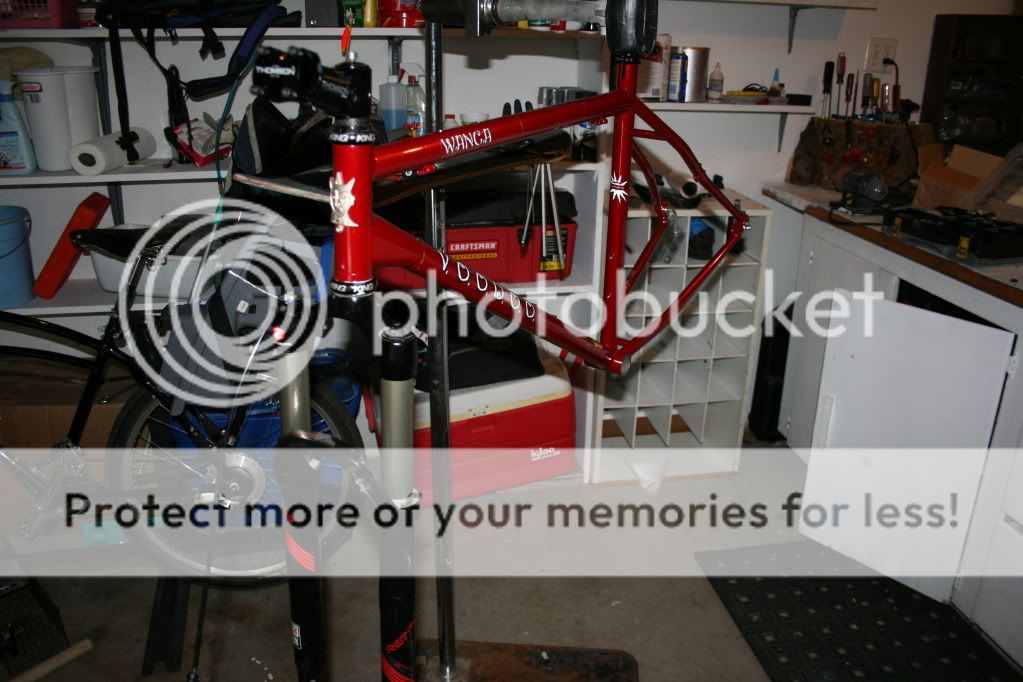

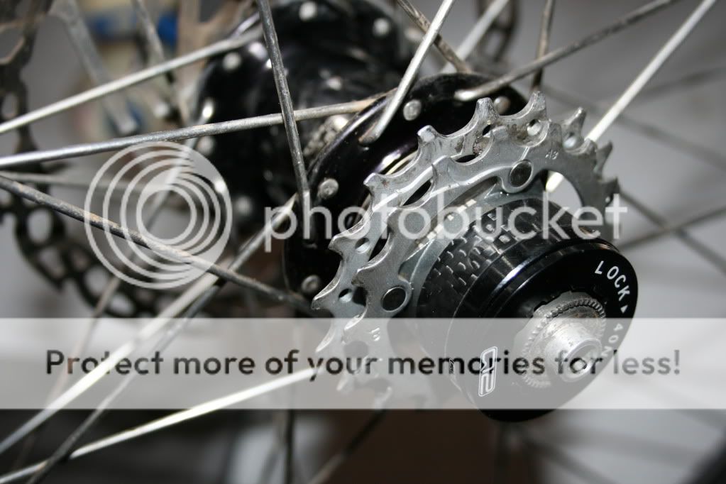

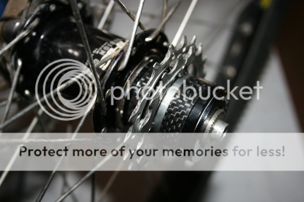

I had all these parts laying around without a frame to hang them on. Money is tight so I needed something inexpensive and I saw the Wanga got really good reviews so I ordered one. I had a Sunrace JuJu cassette that I damaged the big ring on. The JuJu uses separate alloy carriers for every 2 rings so I thought it would be cool to use the 16 and 18 tooth rings until I figure out what gearing I want. The sliding dropouts make it easy to change the gearing very quickly. Here is the build:
Voodoo Wanga in large
Wheels: Mavic 317's with King hubs
Headset: King
Stem: Thomson
Post: Thomson
Saddle: WTB laser V
Cranks: Jones Mod Shimano XTR m-960
Fork: Reba Race with PopLoc
Bars: Easton Monkeylite XC
BB: XTR
Brakes: Hope
Ovaries on the Outside

Those looked like ramped cogs to me. As an agent for the Testicle Protection and Proliferation Group, I can tell you that you, your wife, your mistress, girlfriend and/or boyfriend will not be happy with the results that your drivetrain will assuredly deliver on your next climb.
The cost of two decent SS cogs weighted against the pleasure of a burst testicle...

I thought that may be a problem but I assure you under full power up a rocky climb there is no movement in the chain. If the chainline was off that would be a problem. I think I like the 16t gearing anyway so I will likely buy a 16t and go with that. This is just a way for me to figure out what gearing I liked before dropping the money on a cog. I got the frame new from my LBS but I got a really good price. I like the versatility, I can run it geared if I want and it comes with bolt on canti studs too. Pretty light for a steel frame and the ride quality is nice. The only thing I don't like is the paint chips too easily.

The nicest 3speed set I have seen was on Jeff from Carousel Design Works Monocog - he had a single rear cog and Paul comp Melvin chain tensioner and a tripple chainset / front mech. This gave 3 wide ranging gears with minimal chain line issues (less of a problem on the front as the chain is wrapping more teeth :) )

Well I rode it a bit harder today and had issues with the sliding dropouts moving a bit. Others had mentioned this and said removing the paint from around the dropout would solve it. The chain did not skip at all until the wheel slipped then I had trouble keeping it on. I came home and sanded the dropouts and then I roughed up the bolt plate a bit to give it some grip. Tightened it back up and hammered a hill behind my house standing up at full torque with no movement. I see no need to change from the 16t cog. It is perfect so I will pick up another one next week. Beyond that issue the bike is perfect. The ride quality is nice and lively. Running a 2.35 in the rear was a good choice because the bike is so smooth with it. I had a Cannondale 1fg which I really liked but I always took a beating on that bike. This is much smoother even though almost all the parts came off the Cannondale. Bottom line, great bike with a great ride. I highly reccomend it. For the price it is pretty hard to beat.

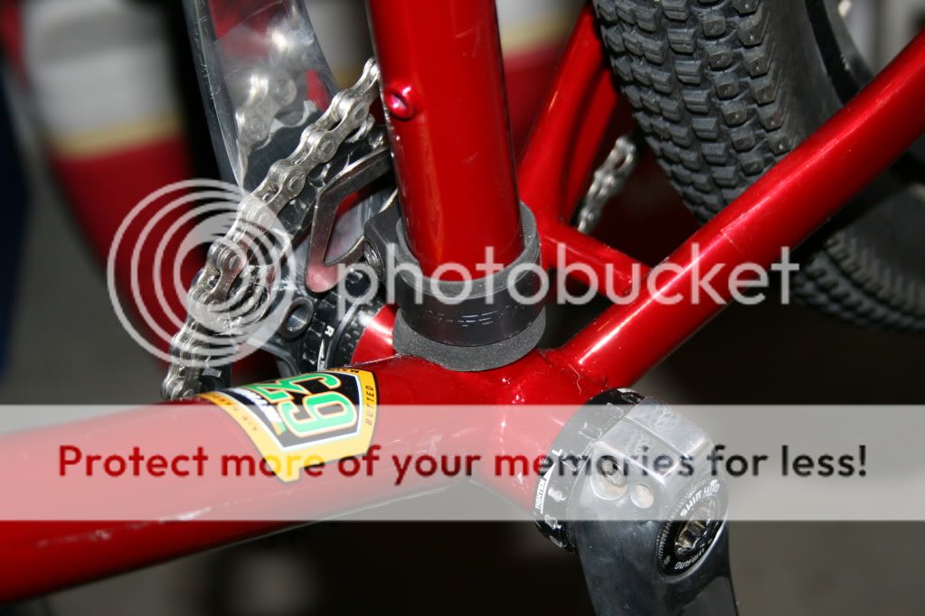

Looking at the size of the carbon spacer used on the drive side of the crank, I have to ask how many threads you have in the bb itself. The spacer just looks large in the picture to me. Neat idea though.
Which Hope brakes are those?
The brakes are Mono Mini's. Very solid brakes, powerful and light but tough to setup. The good thing is once you get them dialed in they stay that way for a long time. The spacer was a 5mm which was wrong. I needed a 2.5 which is what I have now. I used an old skateboard for my tool tray. It is concave so nothing rolls out and I drilled some holes for my tools. Best thing is I paid 15 dollars for the whole stand. It is an older Park Pro with a 50 pound base plate.

You need the White Industries Eno DOS freewheel, two gears in one. Not sue if it'll work with your CKing hubs though? Do they take a screw-on.
Nat
The ENO Dos Freewheel will not fit on the CK hubs, they are thread on type rather than cassette type. There are companies that make double cogs for cassettes (I think, can't think of them off hand) Could always use a pair of single speed cogs spaced appropriately for the same effect. If you went this route, I'd also suggest running 2 chainrings and 2 cogs, each spaced 2 teeth away from eachother ie., 16/18 cog matched with 34/36 chain rings. You could run a "dingle speed" (search it) and the 34/18 would be close enough to the same chain length as the 36/16. Townie gear and mountain gear without any adjustment, Yay!
