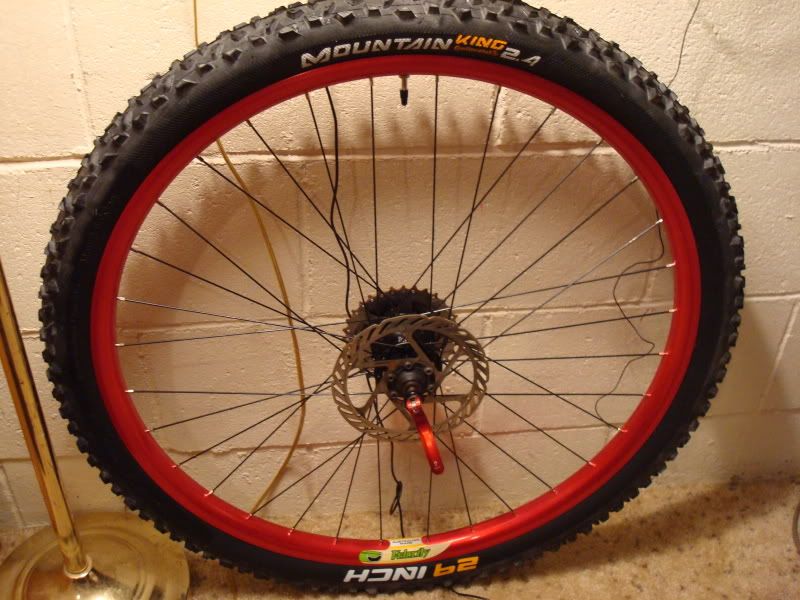

These are awesome wheels. They aren't the lightest (cant recall how much my build weighs) but they are laterally stiff and very compliant in the majority of terrain. I like them alot, they make my already wide tires wider. I've heard of problems with people running too low pressures and getting rim dents, I have had no such problems. Aaron, the great kid who built my wheels at Mosaic has almost the same set, put a pretty big dent in his and they still run true.
I have had no problems personally. I just wish they where a bit lighter, but they work very well for the XC setup I have. Ill try and post some pics later today.

that red rim is awesome.
that is all.
