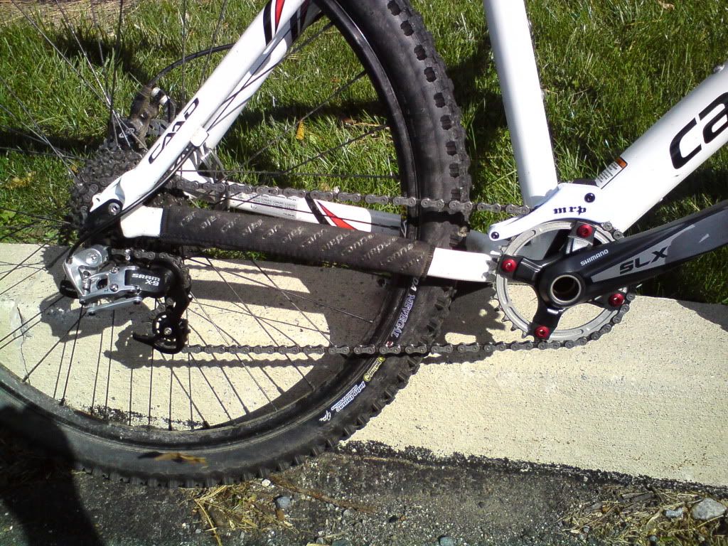

I underwent a 1x9 conversion a few months ago on my '09 F4, and part of that was upgrading the crank to a Shimano SLX, which was a substantial upgrade. Way better feeling than that Octalink thinger that came on it.
For what it's worth, I went SLX because it's damn near as good as the XT crank for a lot less money...
Wheels will definitely make a huge difference in feel, but I'm content with my stock wheels until I break them. And until I lose 20 lbs and improve my skill.
Here's a closeup of my drivetrain upgrade. All at once, I went with a SLX crank, e.Thirteen 32 tooth ring, Sram X9 shifter, Sram X9 short cage derailleur, and an MRP guide:
You will notice a huge difference going from X7 or X5 or whatever we had stock, up to an X9. Don't bother with X0 unless you really give a crap about the few extra grams, cuz the X9 will perform basically the same from what I understand, plus cheaper by far if you break it. My shifts are super quick and smooth now.
Oh, if you're sticking 3x9, the rings that came with the SLX crank were nice. But I'd totally upgrade the shifters/derailleurs before the brakes.

Well, it felt like a hell of a lot, but I also dropped two rings at the same time. But it just feels way more rigid, seems more efficient.
If you like your shifters/derailleurs, then I would say keep them until you find yourself not liking them or they break. But there is a much crisper and quicker shift when I went to X9. I dunno about going to X7.
That's a beautiful looking set up man. Fun lookin' too.
