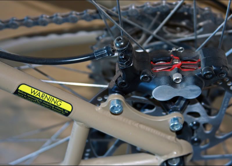

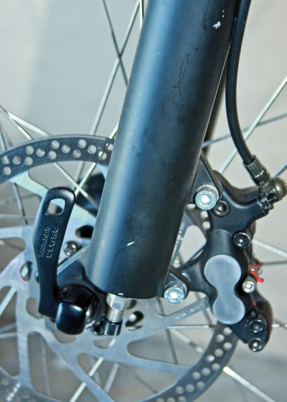

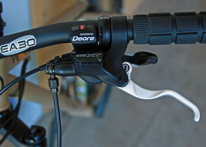

I had some avid Juicy 5's for a couple weeks but came across these and couldn't pass up the deal. Found these XT m755 brakes on craigslist and they were on a display bike with very little wear on them. they had painted over the shimano xt, and started scraping it off the calipers, then gave up and put some silver paint over those. some nail polish remover and some elbow grease cleaned things up nicely. new lines and some Kool stop pads and everything is perfect.
on the rear I had to take a bit of a risk, because of the way these brakes are mounted I had to take the dremel to the mounting holes to make them a bit oblong to make sure the pads lined up with the rotors correctly. still have plenty of metal around the mounting bolts so it should be just fine.
these things are GREAT, stop so well it sometimes get scary :thumbsup:
