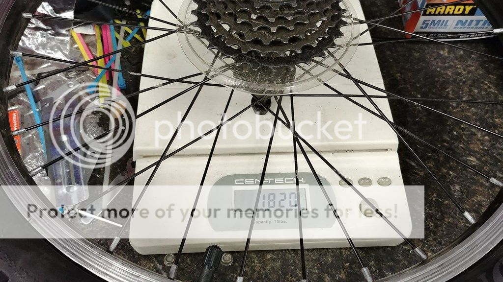

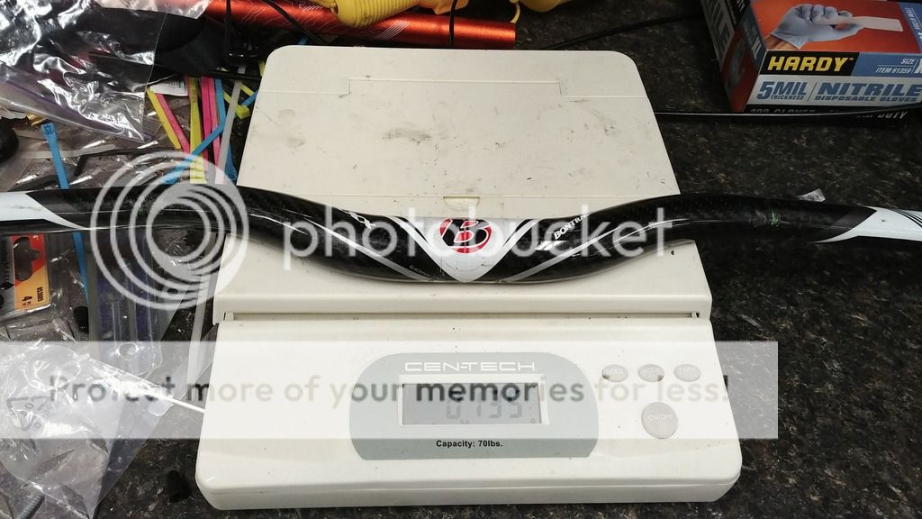

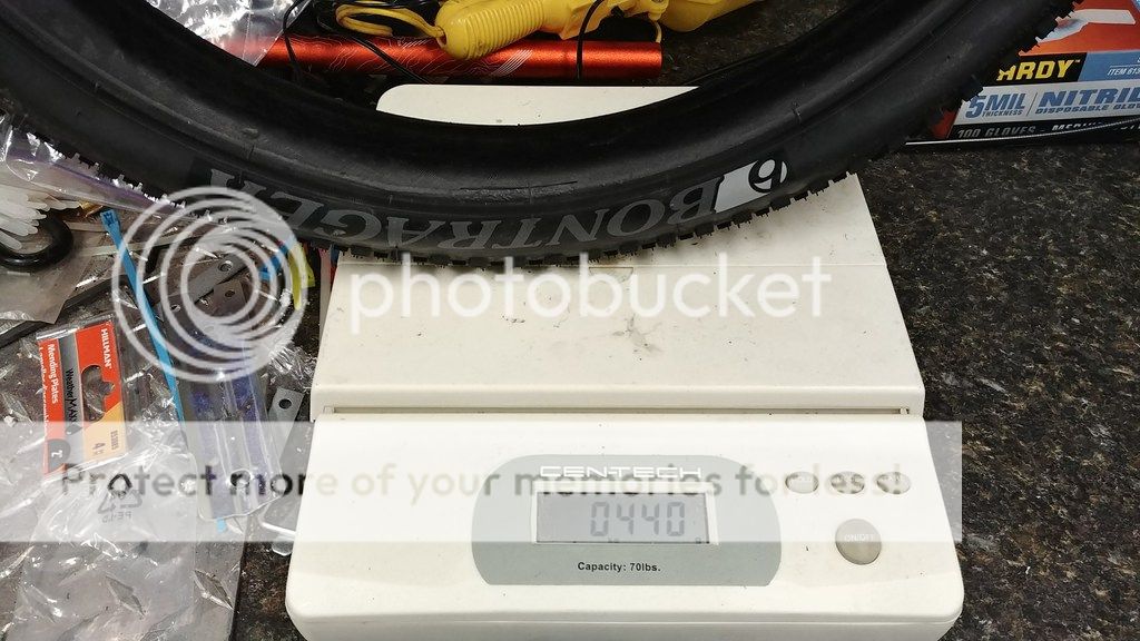

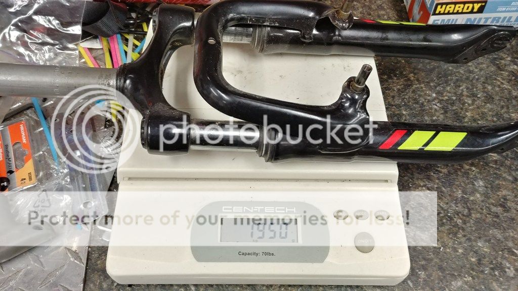

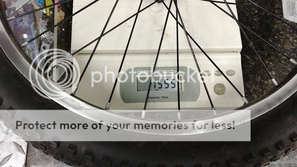

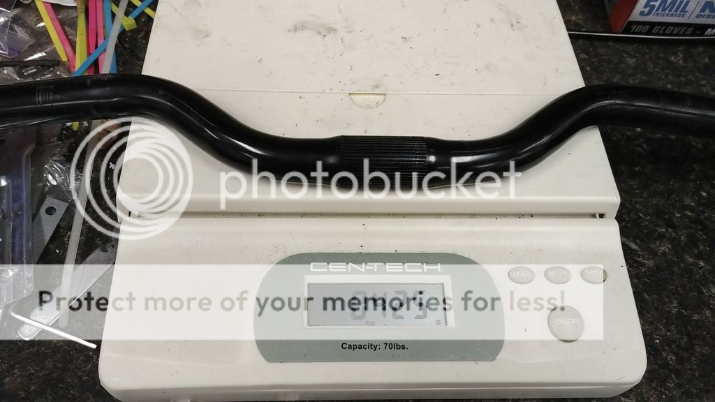

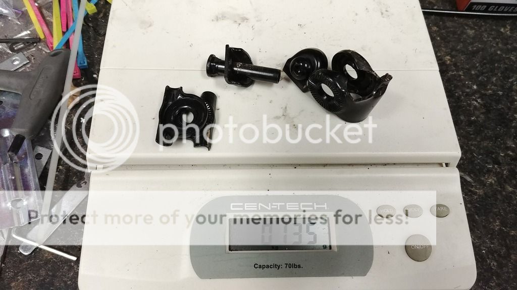

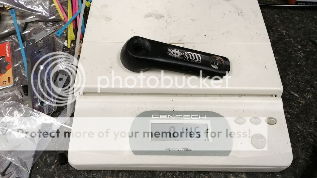

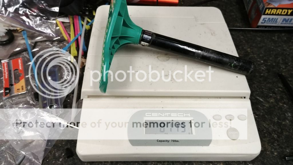

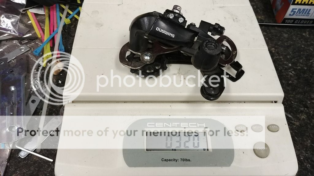

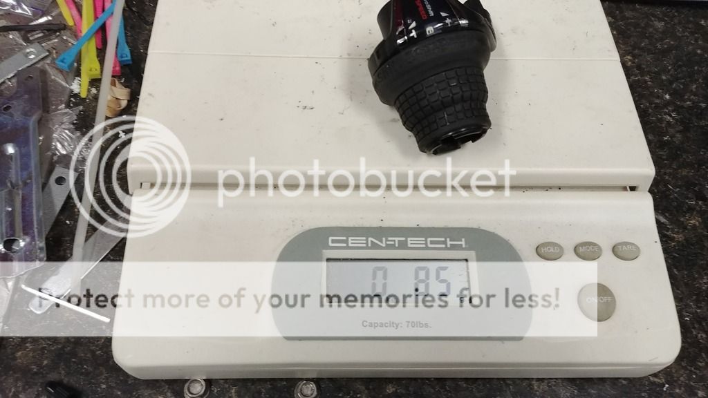

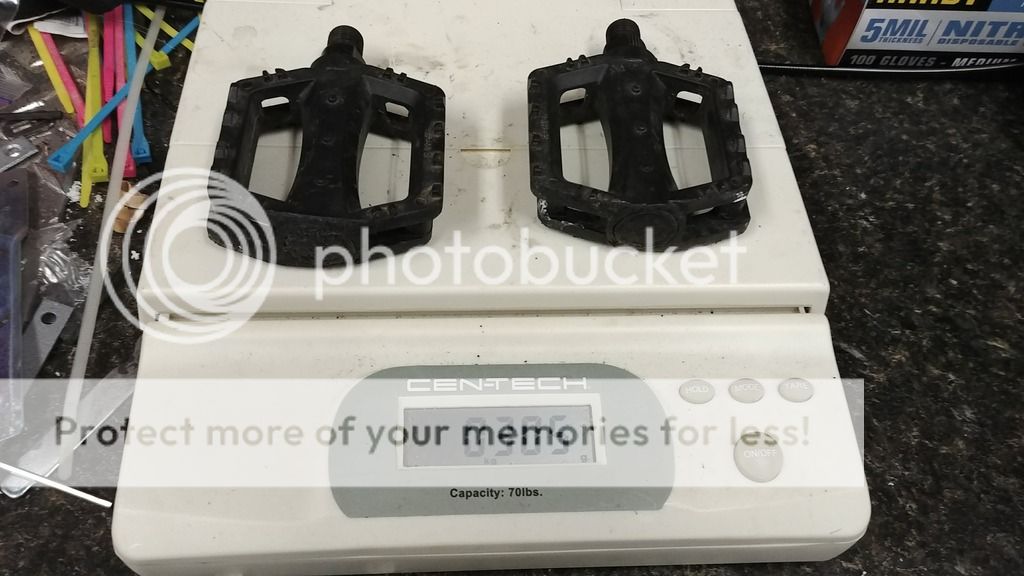

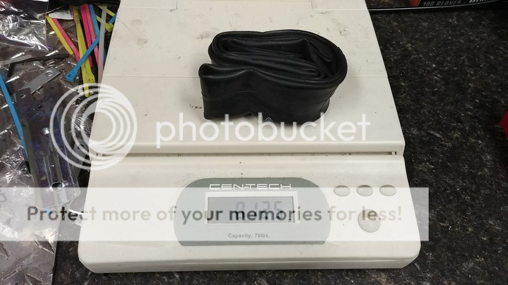

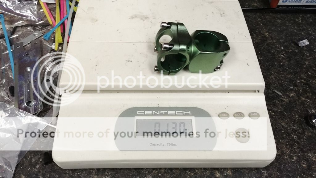

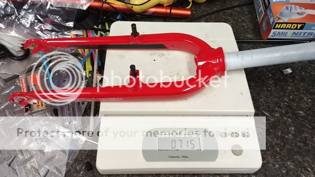

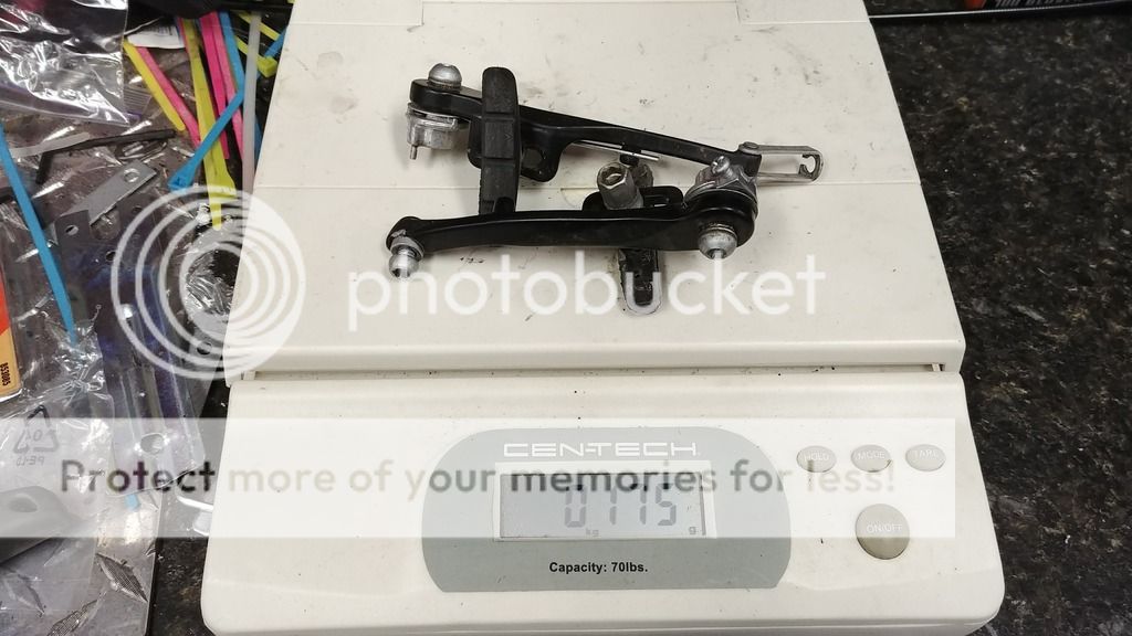

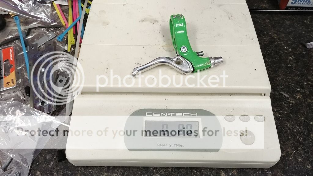

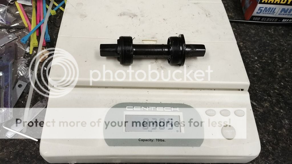

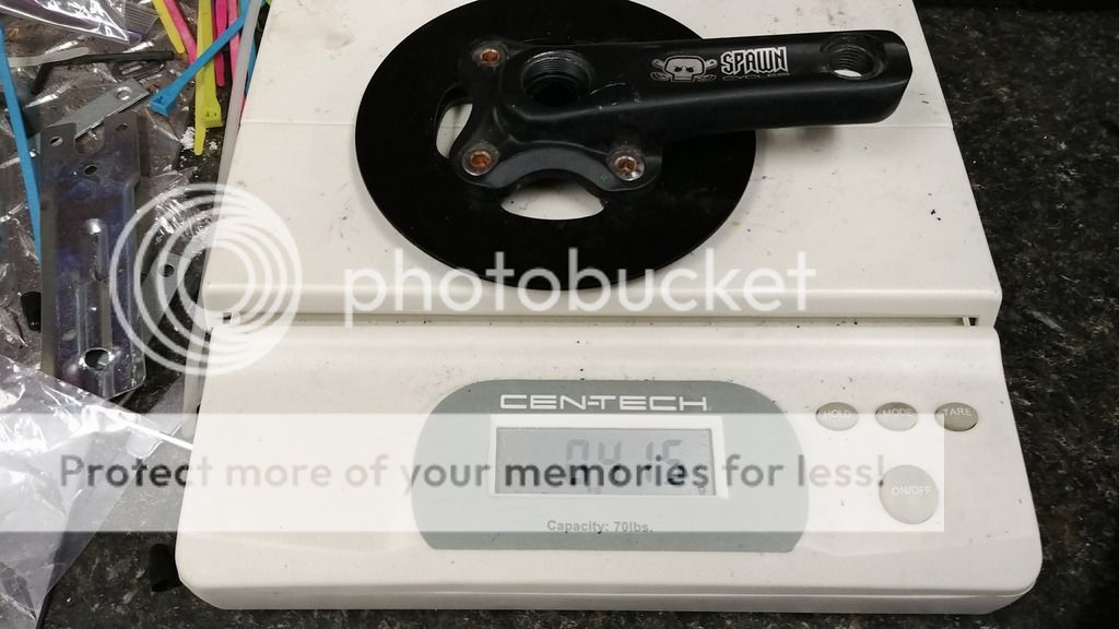

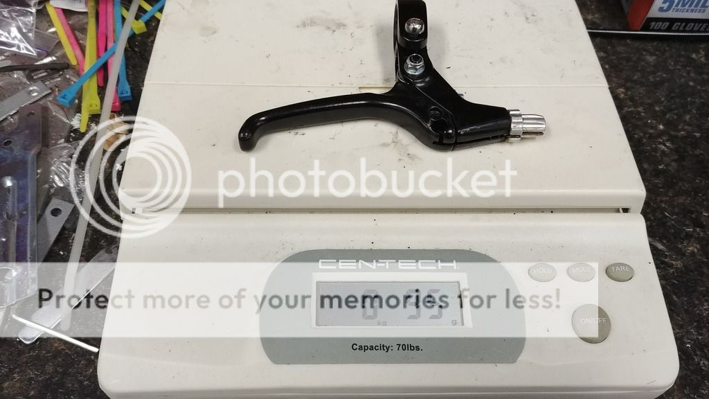

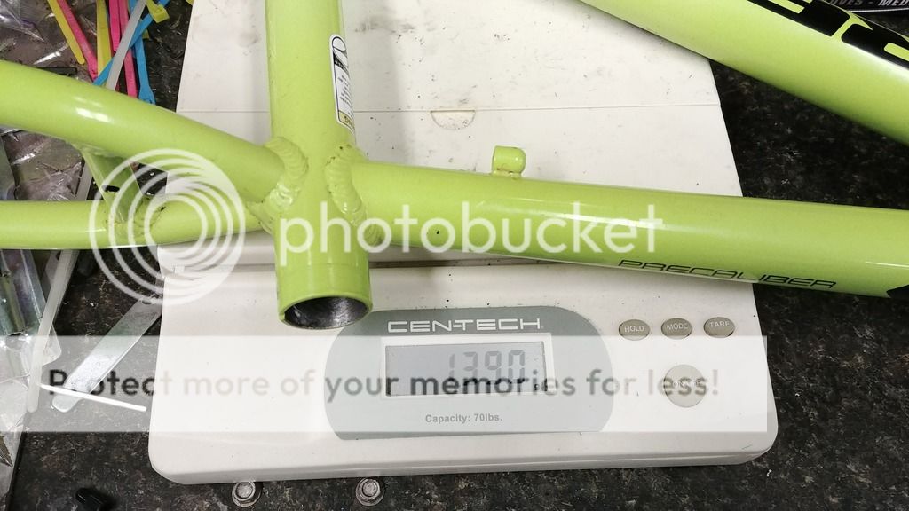

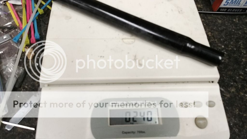

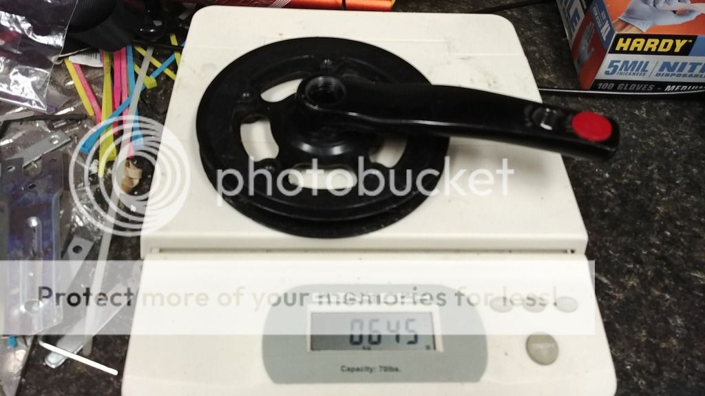

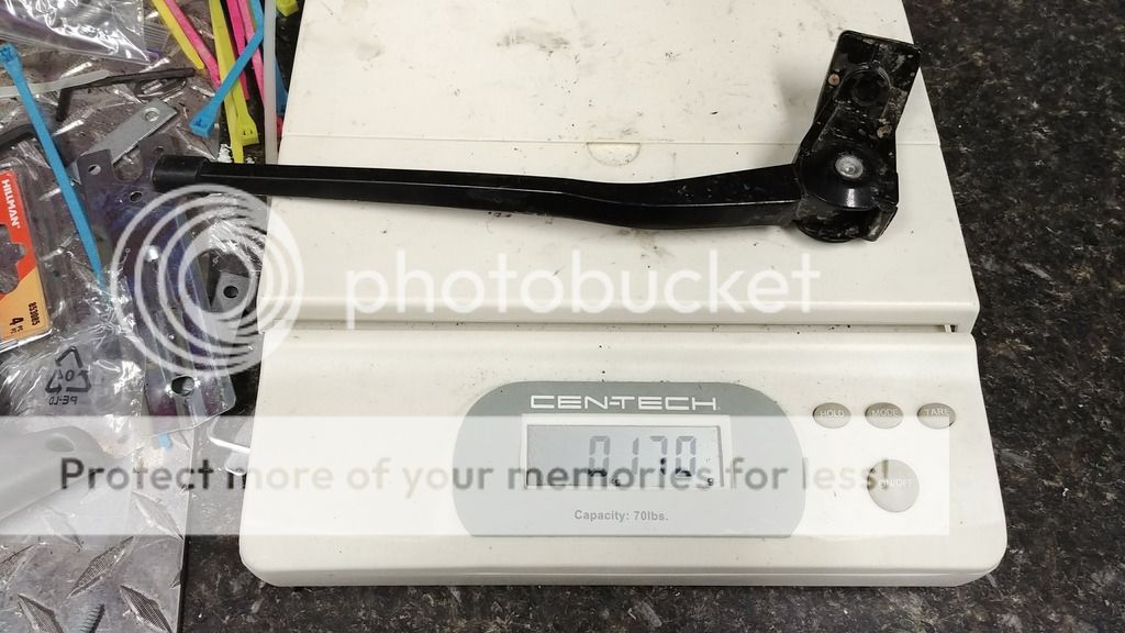

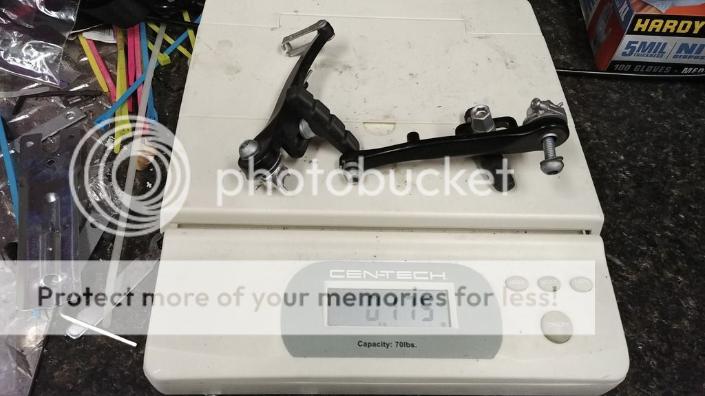

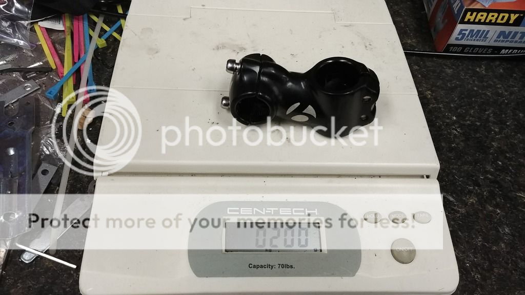

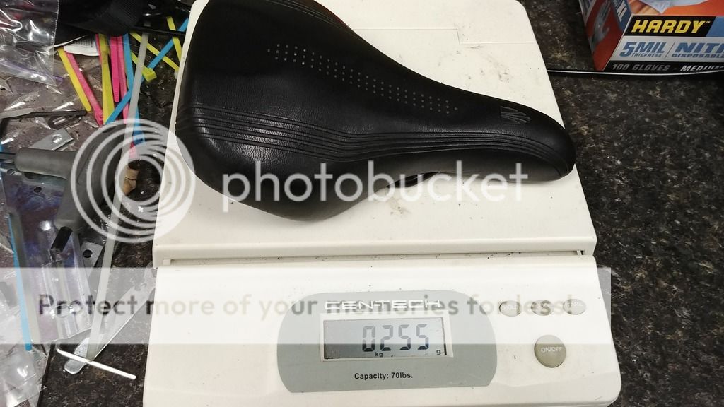

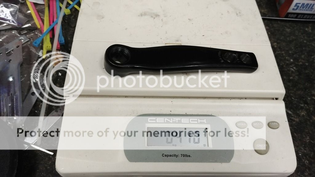

I tore the bike down to the bare frame and weighed all of the parts as they cam off. Weight as it sat stock was 25.4# I also tore down his modded Hotrock 16 which weighed 16.0# I'll be using some of the parts off the old bike like the carbon bars and hopefully the saddle/post combo.
861 Posts
Discussion Starter #15
well that's all the major components. I have all the small stuff too, but until I need grams I'll worry about the big stuff first.
