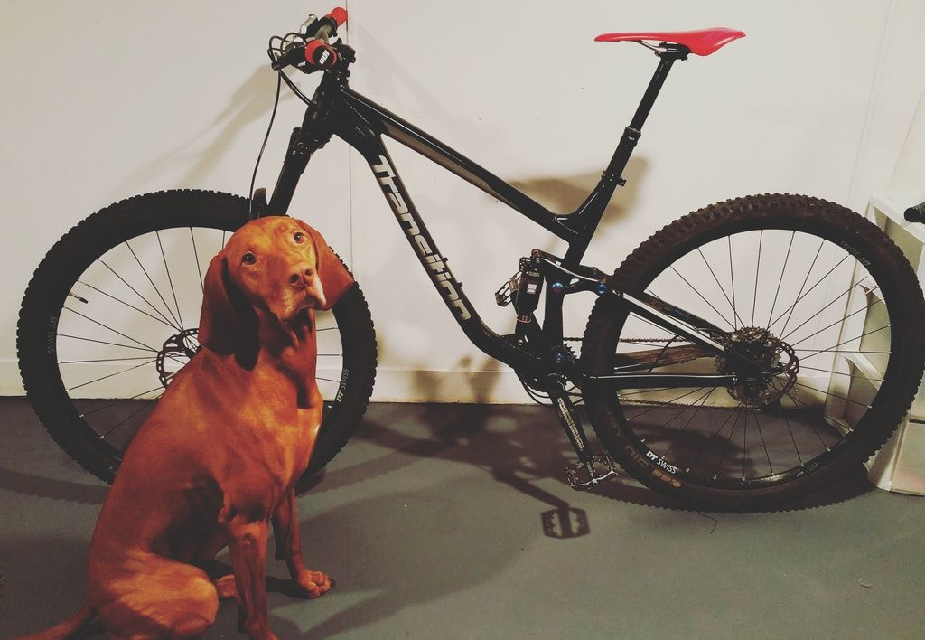

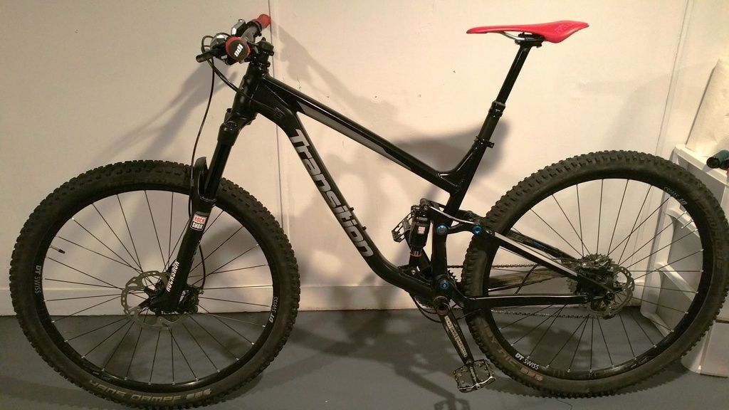

Hey guys. I picked up a 2015 Smuggler off of CL for a good deal. My HD3 is a bit overkill for many of my rides and my Superfly HT isnt quite enough for some of the terrain, so I was looking for a short travel All Mountain bike and this guy fit the bill. Obviously this isn't a weight weenie bike, but I want to drop a little weight off(maybe get close to what the HD3 weighs).
2015 Transition Smuggler Lg frame, Monarch RT3 Debonair ~7lbs ish
130mm Pike RC
Reverb stealth 125mm
DT swiss XM1900 ~1940g
Hans Dampf 2.35 Front~ 860g/ Nobby Nic 2.35 rear 765g
Shimano Deore brakeset with Ice tech rotors 180/160
Race face turbine bars 725 wide ~255g, and stem ~163g
Selle italia SLR test saddle ~150g
Race face ride crankset 1x ~ 800g
Race face BB ~140g
Shimano Deore 10s shifter
Shimano Zee rear der
Sram PG1020 cassette 11-36t
Grips TLD ODI ~ 118g
Upcoming upgrades:
Tubeless ~not sure
X1 Carbon Eagle crankset with wolftooth 30t DM ring ~550g (250g)
Renthal Fatbar Carbon 200g -Installed (50g)
renthal apex stem 130g - installed (33g)
Sram GXP BB ~not sure
I know I am missing stuff. Looking for input from you wonderful gentlemen

Your hound seems to be reproaching you.
Looking over your spec list, I'd start with the wheels and cassette. Tubeless will cut some weight (plus other benefits, imo), but you might not be keen on that.
Slimmer tires would shave more grams, but there are tradeoffs to consider there.
Good choice with the carbon crank and bars, btw. I went that route last season (RaceFace Next SL G4 and Easton Haven) and it seems to be money well spent.

Jackson (my dog) is pissed that he hasn't had much trail time. We have a foot of snow and a new baby boy.
I got the crankset as a new take-off on ebay for $150. Bars and stem I had laying around.
I run all my bikes tubeless. Not sure why anyone still runs tubes these days.
I am researching what cassette to go with. The current cassette must weigh 450g. I might need a wider range than 11-36t but I am not sure yet.
The wheels are the obvious weights on the bike. Currently saving up for a nice set. Looking at the American Classic Race set that is on sale for $500 right now. 1459g. any other options?

You could drop another 100g off the crank with the RF Next SL G4.
Garbaruk: 11-45T Cassette - Garbaruk Lightweight Components
They're supposed to be coming out with an 11 speed really soon as well, and it's supposed to have a 11-50 option. These aren't cheap, but they're lighter than SRAM and way lighter than Shimano, while still using a normal cassette interface.
You could go with ESI grips, replace all the bolts with ti, there's enough on this bike to save a bit.
Instead of renthal, Easton SC90 SL or Raceface Next save a bit more.
Get a 1500g wheelset, this would be more noticeable than everything else listed combined.

I wouldn't waste money on the 10spd garbuk, get a good 11spd derailleur like XTR (223g) and a good 11spd cassette. There are a few better options now. If your DT hubs are star-ratchet drive, you could use the 1up freehub carrier with the Hope cassette (268g for 11-40t) or the SRAM 11spd cassettes, of which X01 is about the best deal, or the new E13 cassette. XTR isn't bad, but at 320g or so for the 11-40 it's not super light. But these are the cassettes you'll be able to pick up for years to come. Investing into an expensive 10spd cassette is not really worth it IMO, money better spent on 11spd components.
Although I have XX1 cranks on my AM bike that I have beat to hell since 2013ish, the Next are significantly lighter (and stiffer iMO). They hold up great to AM riding for almost everyone and are speced on all kinds of AM bikes as stock equipment.
