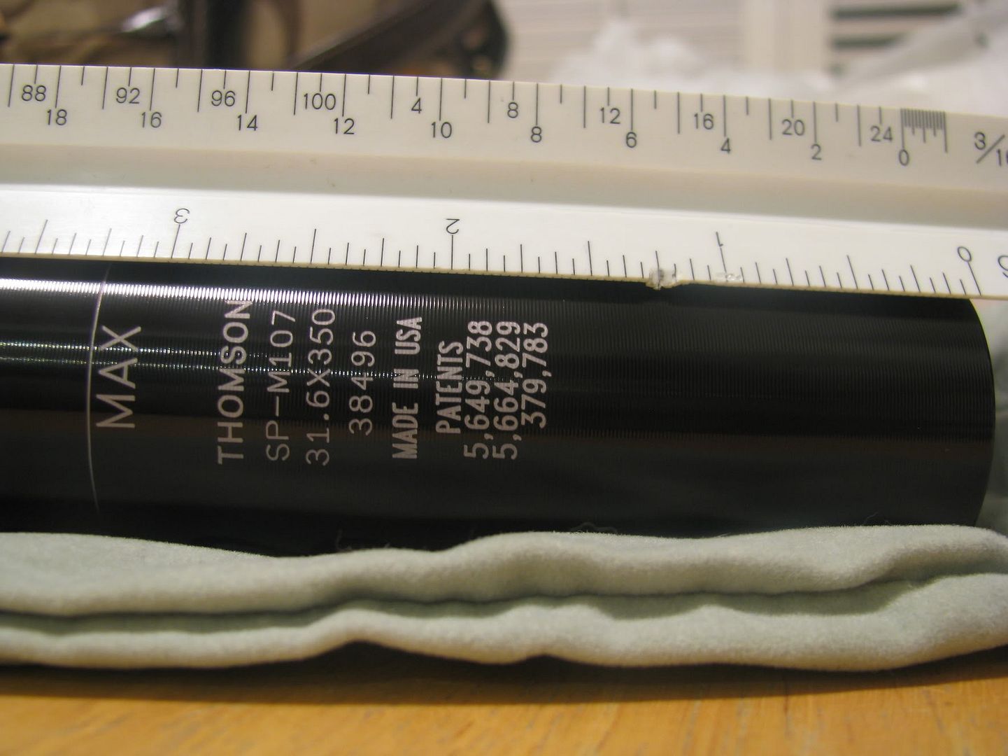

I have a 31.6 x 350mm Masterpiece seatpost.
Minimum insertion is 3.25"
Weight is 190g on my scale. My dog chewed the ruler!!!
Hope this helps,
Kevin
wow, hey thank you very much Kevin.....exactly what I needed :)
