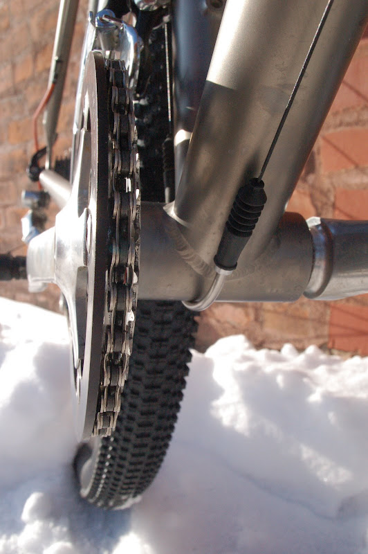

Drive train set up is 2x8. 11-32 x 28/32 shifted by nice retro XTR M900 and SunTour XC Pro. Velocity hubs laced to Salsa Delgado races. Avid BB7's. Fork is a Bluedog Custom, filletbrazed.

Had to get creative with the front derailleur cable routing. There was no hole drilled/tapped for a guide. I wanted to run gears on this, so I had to come up with something. An old[well, new really] v brake noodle to the rescue! Should work well, I think.

I wouldn't think you would have any problems using a noodle like that
Very cool Marty. Nice take on the cable routing, both along the top tubes (crossing and then tucking into the bridge there) as well as the noodle for the front shifter. You'll enjoy that bike a lot I have a feeling!
