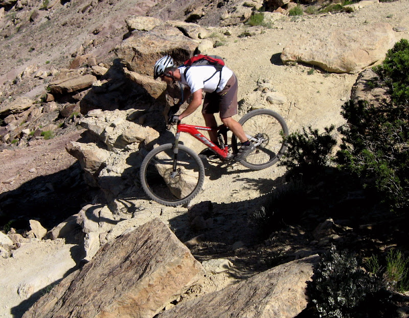

First few chunky moves off the top.
We stopped and chatted several times on the ride, mostly discussing the tires we were riding. This tire has a reasonable chance of being produced and shipped quickly, so our riding and discussion today focused on tread pattern, apparent casing durability, and tread compound. Precious little scientific terminology was bandied about--it was more along the lines of 'Holy ****--did you see THAT?!' or 'WOW--I can't believe I got away with that one!'
John biting off a bit more than he had bargained for.
A heady move that I don't care too much for. John snapped this one a bit early but you can clearly see the dark flat ledge that my front wheel is about to clear. The front wheel doesn't touch it but even if you 'ride light' the back slams pretty hard. On a normal (non-tire-testing) day I'd unweight the rear end as I slammed into it to keep from flatting or denting the rim.
Today I sat back and kept my full weight planted on that sucker. Harsh noise and a minor dent but no flat. Time to start dropping the pressure. We'd both started at ~20psi but it was time to see how low we could go.

These are ~95g Bontrager 26" tubes. On purpose--we're trying to determine how much the tire can take before transferring the impact to the tube/rim.
Squirmyness got worse with speed, but as speed picked up we also left rock/hardpack and got onto the ball bearings so it could be the surface as much as the pressure.
But I think 15-16psi is really ideal with this tire. Best of all worlds.

Bottom line? No comparison between these and anything else. Single ply to ~dual ply never does compare for this kind of riding. These are my 'home trails' and I've ridden most of the available tires on them for the least few years. Neve's and Ramps or (insert your favorite tubed or tubeless 29" tire here) would have been cut/pinched on the moves/lines pictured even with 300g tubes and 40psi today. Stouts do a bit better, but I still would have had to run them at ~30+psi *and* be very careful. Big difference in traction and confidence between 10-15psi and 30+.
These are and will be heavy tires by any standard, but what price flat-proof? I'd much, much rather have too much tire in these instances than not enough. Wouldn't you?

Both are John's Rhyno Lite rims. The dents are not surprising all things considered (speed, PSI, terrain, indiscriminate line choice if any at all, etc...), but the flat spot in the first photo speaks volumes. Still no flat tires. If it was going to happen to either of us, it would have happened today.
Someone out there can probably flat these but it ain't gonna be easy.
Testing has now switched gears to focus on tread pattern and compound.
