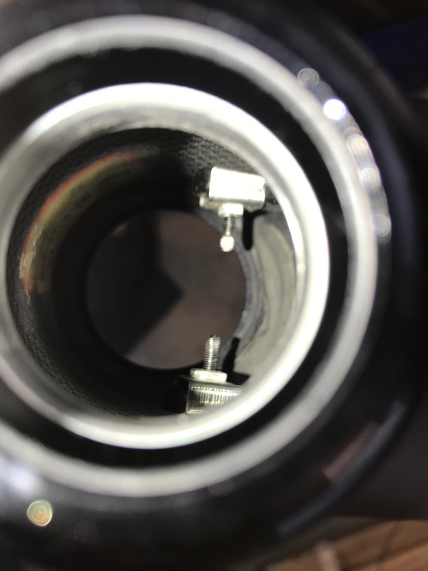

The internal cable inserts were mixed up with the holes being too small on the brake side stay. No big deal to drill out or swap with the other side. Still had to drill a few out. The ones near the head tube were another issue - the bolts holding them in actually intruded into the head tube area and hit the steerer tube. I had to shorten them ... again, not a big deal.
... cut down the long screws that intruded into the head tube without issues. Dropper cable was a little bit of a pain but I got it in ... TIP - route all cables BEFORE installing forks. That makes it much easier to grab the cables as the come into the head tube area.

Screws protruding into head tube area.

I am looking at a full suspension Chiner frame for next season. I have been riding a WorksWell 062 hardtail for the past two/three years. Just seeing the quality control with the headtube bolts makes takes this frame off my shortlist. If a builder has such blatant disregard for quality in an obvious location, I wonder about what cannot be easily seen.

Yeah. I think the bolts only needed a mm or two to clear. Not that big of a deal. Everything else looks good.

Regarding the quality control on the headtube bolts, frame accessory QC is sometimes overlooked by these sellers, that does not mean the frame QC was overlooked. Every frame model has been destroyed at the factory at least once in testing. This is done to ensure that every model frame exceeds international industry performance standards. There is a whole book full of testing protocols that they follow (ask them for a copy) if you're still skeptical. Not to mention, if a frame breaks within 2 years, they need to replace it, and that would put them in the hole since their profit margins are so small.
