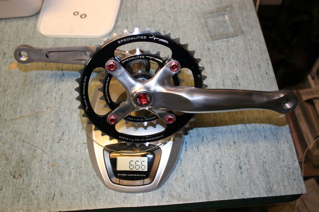

40/26 the TA-way:
Test mounted yesterday and with a DA fd and a 9-speed chain (will mount a 10 later today) there was barely any rub in any of the extremas when hanging in the jig. Happy happy...
