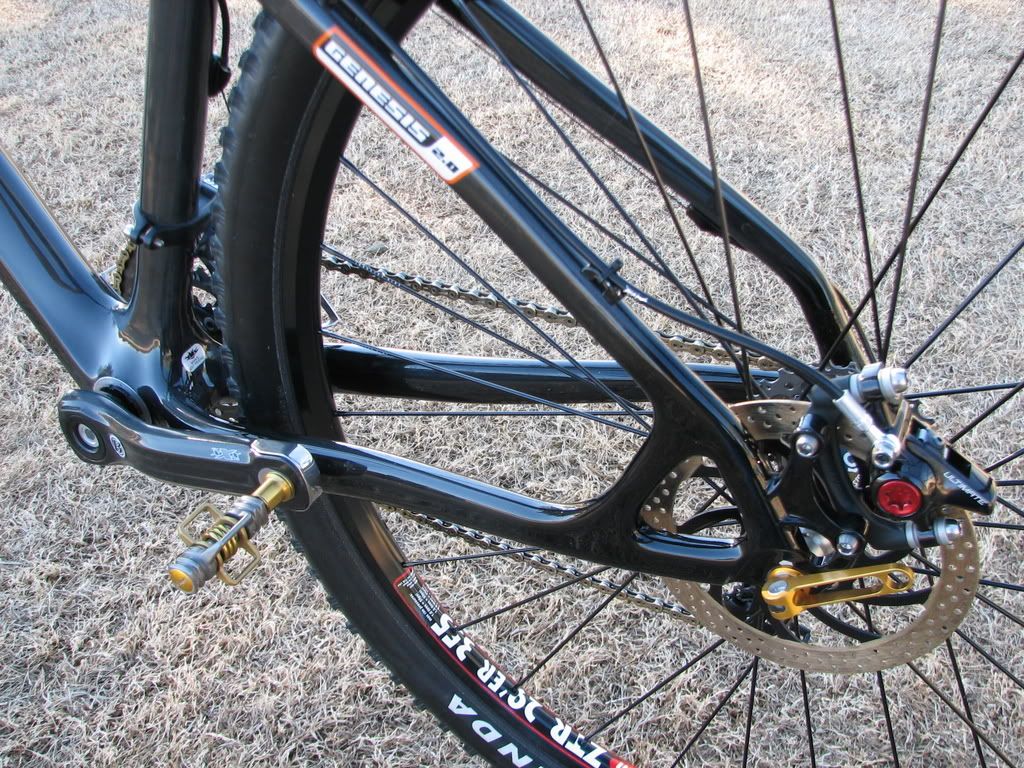

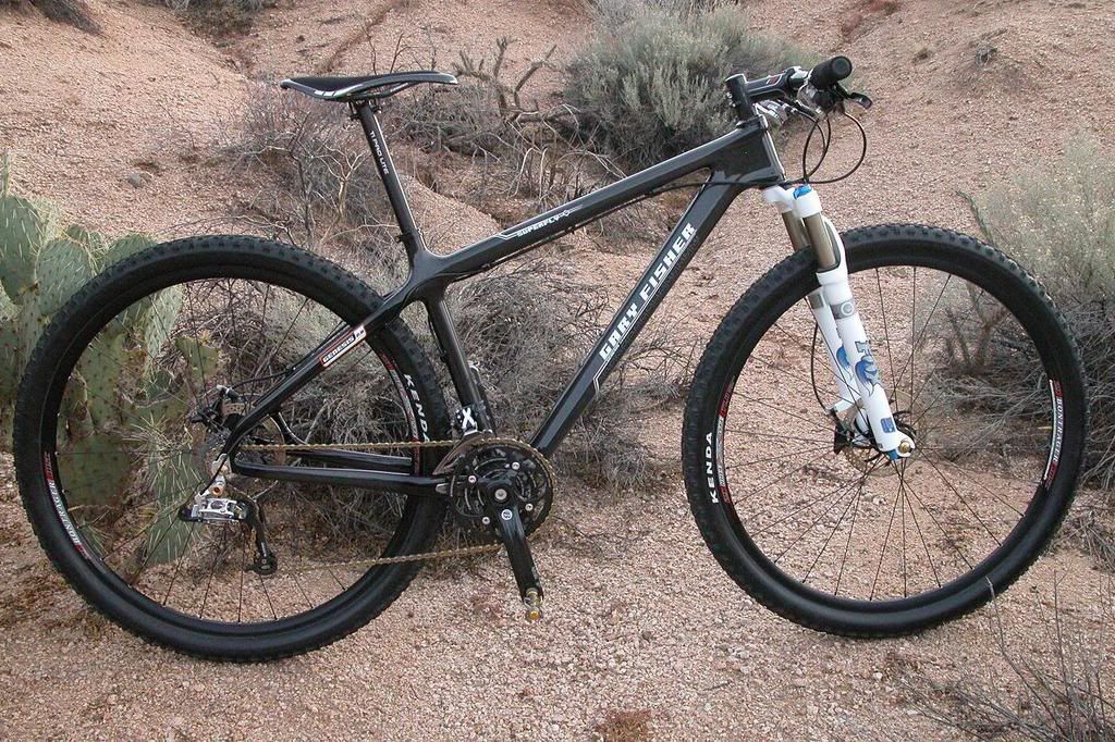

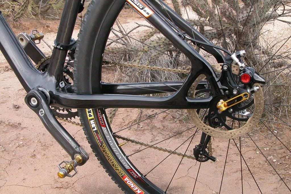

***PICTURES ADDED***
Now at 19.92 lbs with I9 wheelset, Kenda Karmas, tubeless.
The frame size is medium. For the weight weenies out there it currently weighs 19.92 lbs and I'm still using tubes.
Bontrager XXX crank, 553 grams
American Classic BB cro-moly, 157 grams
KMC chain
Sram XO rear w/M2 Racer carbon pulleys, 179 grams
Shimano XTR front
Dura-Ace 12-27 cassette
Crank Brothers 4ti pedals

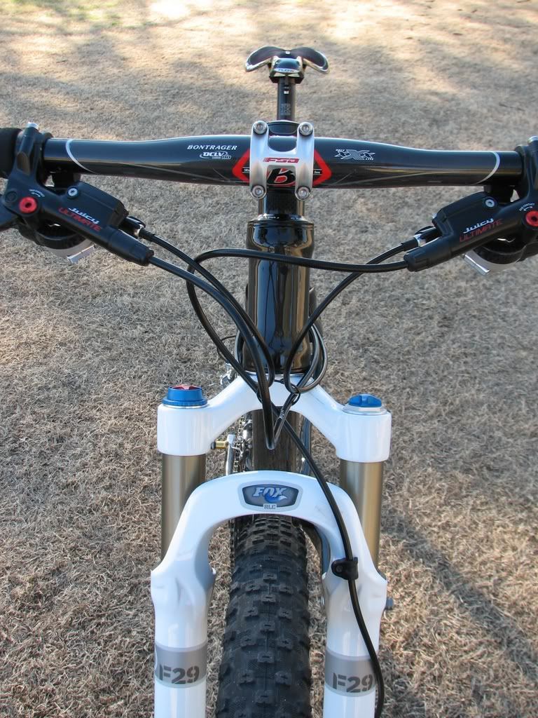

Bontrager XXX 580mm flat bar, 112 grams

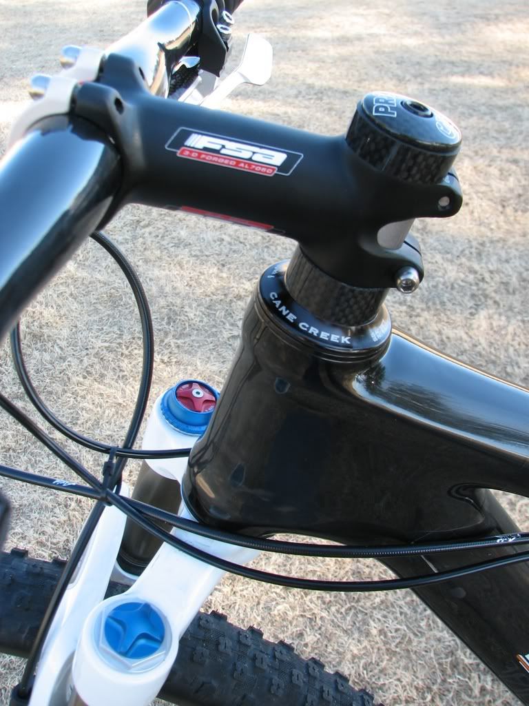

FSA OS-99 stem (not pictured) 98 grams
Cane Creek ZeroStack 6 head set

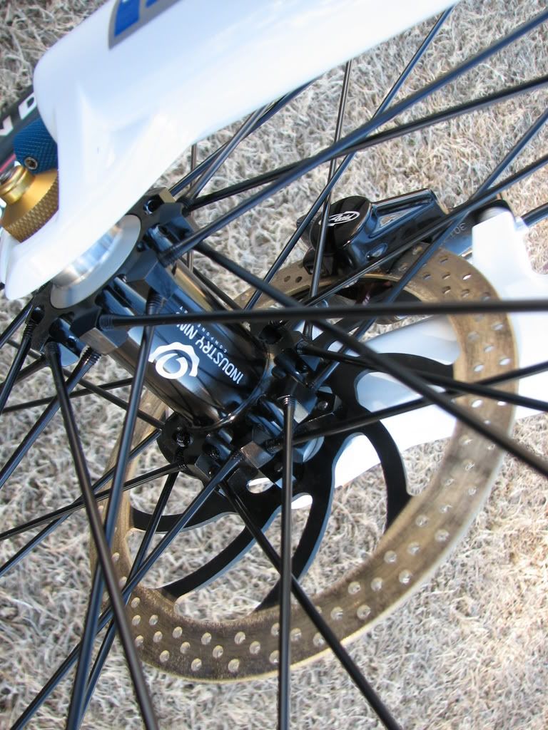

Avid Juicy Ultimate
Stans 160mm rotors
Selle Itailia SLR Carbon saddle, 96 grams
KCNC Scandium post
M2 Racer post clamp.
Bold Precision Ti skewers
Bontrager Race X Lite wheels
Kenda Karma tires
Maxxis Welterweight tubes
Only Ti bolts & screws throughout
Stem Pictures added page 2
