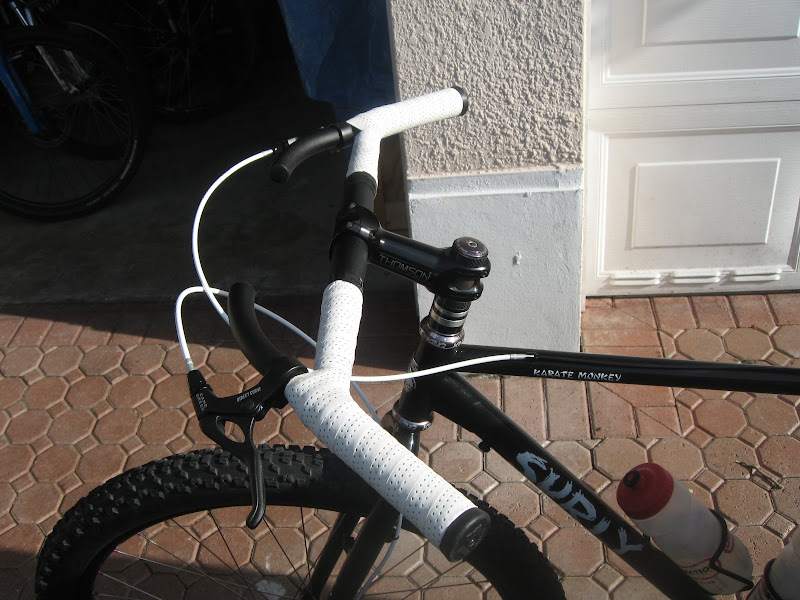

I much prefer a stiff control setup - too much flex and you can get a vague feeling (i.e. former use of a Ritchey 4axis and Easton EC70 - lots of twist). I get some compliance through my 2.4 Ardent (tubed) at 20 psi. Alt bars come in to play here too since the sweep of these facilitate riding loose IMO.

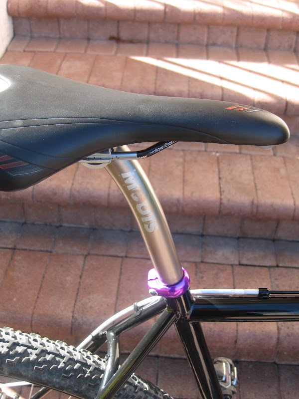

Ti has it's place though (even on a Karate Monkey ;)).....I wish I would have picked up a Ti seatpost much sooner!
