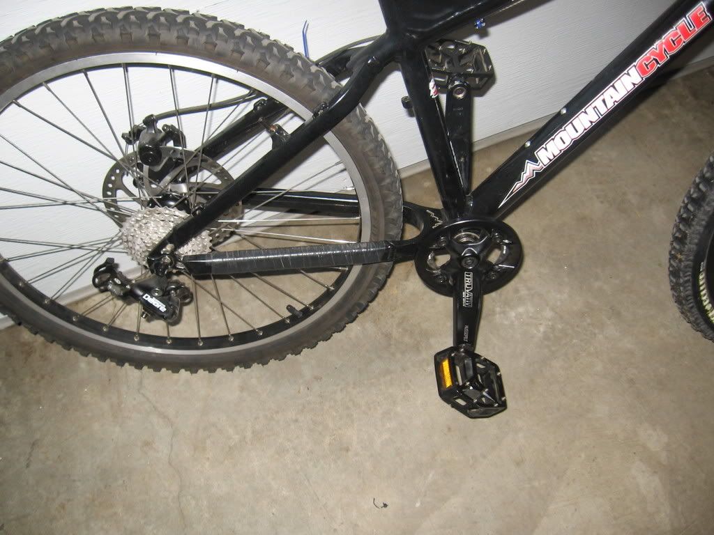

well, for quite a while I was trying to sell my 04 MC rumble frame. eventually I was trying to get rid of it for $110.00 and figured it wasn't worth it. its a decent frame (never built it up though) made by knesis when they were still in Portland OR.
my current AM hardtail was a ironhorse yakuza bakuto. and it was an okay bike. but it had a 23.7" toptube on a 17" frame...so just really long and very big and sloppy. (great for FR, not so great for AM) so one day, I weighed the bike .... 45 pounds. thats 5 pounds more than my DH fully. so, I decided to completly scrap it. and to start building this rumble.
upon going through spare parts. I wanted to make a pretty light AM bike. somewhare withen the 25-30 pound range. I realize I don't have the lightest components on it now.
so instead of a drivetrain, I was thinking of going SS. does anyone here use SS on an AM bike ? I will also be kind of street riding it a little (as I do with all my bikes) but ultimatly, I was thinking of it being a 130mm travel 25-30 pound SS AM bike.
heres the specs so far.
Mountaincycle Rumble frame 2004
Manitou Splice Comp (4.1 pounds)
Hayes "IH" 2 mechanical disc brakes {heavy, would also swich to 160mm rotors}
Forte' 8 speed brand new casette
Deore RD, Alivio FD with Alivio Shifters
Truvativ hussefelt cranks, single 32tooth with bash.
some strange brand platform pedals with replaceable pins {really light weight}
hussefelt bars and stem
thompson elite seatpost/Specialized fuse saddle.
Rhynolite/Deore rear wheel, Specialized bolt on/Ditchwitch front
So I was thinking of being able to save some weight by going SS, would this be an okay choice for more AM duities? I really kind of want it to be a light bike. I was thinking of a 32X16 combo.

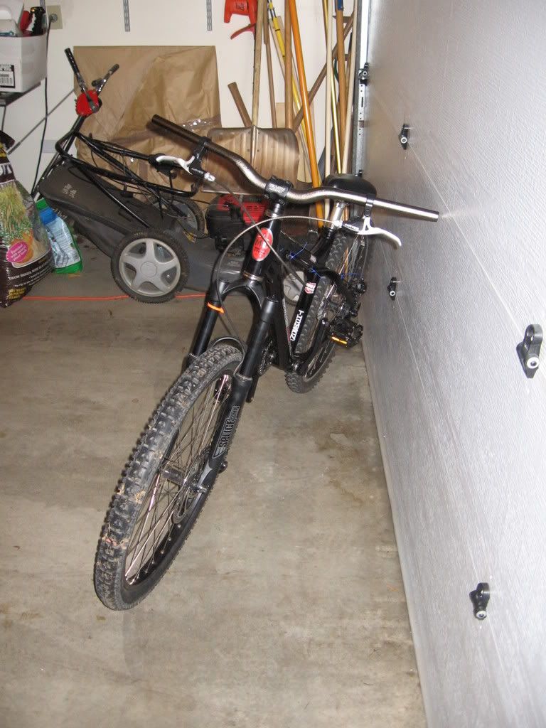

here are some pictures of the build.

you've got one cool bike, looks like a real nice setup :D how are you liking the tora?
I ended up going 32X16, I'm awaiting a rennen tensioner.
heres some pics of the updated build
the specs so far are.
2004 or 2003 MC rumble frame, size M
2005 Manitou Splice Comp 130mm
Hayes IH2 brakes
Maxxis Highroller 2.3
sunrims ditchwitch/Specialized front and Shimano alivio/ WTB dual duty FR rear.
Truvativ hussefelt Cranks/Bars/Stem
Thompson Elite seatpost/ Specialized Fuse (soon to be a speed V)
obviously theres a little more specs, but this will just give you a general idea.
