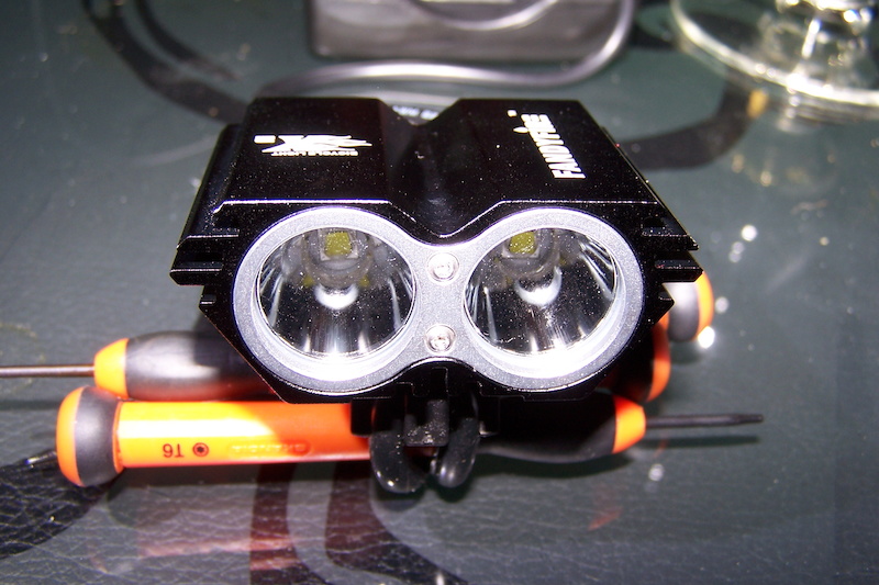

Just got my Fandyfire X2 from DX this week.
I waited for it quite some time (2 months).
It arrived in a big enveloppe "Per Avion", by airmail.
This week iI used it a few times for commuting, so far so good, I'm impressed.
Because of the findings in this thread I opened it this evening.
The screws on the front are drilled out / damaged, so I opened it at the back.
Soldering looks ok.
There are traces of thermal paste visible. At least someone did make some effort to keep things cool.
Not shure if this is the back of the star or the pill we're looking at...
I have to take out the leds from the front, have to find me a pair of pliers to unscrew the front srews.
Here are some pictures.
Hard to tell for sure from the photos, but looking at the 2nd one it seems like the back of an LED MCPCBs showing.
^^ +1
it seems we are looking at the MCPCB, at least I think you have the original driver.
Based on the second photo, I don't think the leds are heatsinked.

Well I just finished taking my X2 clone ( Manafont version ) apart at the front just so I could see how the emitters were mounted. For the record mine has no "Solarstorm" logo or other markings.
First I'll note is that my clone has the loose emitter boards like some of the others. There is no pill and no metal base plate for the board to rest on. For that matter there is only a small indented lip that holds the MCPCB in place. It is so small that I'm amazed there is any thermal transfer at all. No thermal paste was used to keep the board in place. Looks like I'll have to buy some thermal paste to get the boards to hold tighter to the indent lip. What a crappy set-up. The original Solarstorm X2's were built much better. At least this explains why mine seems to drop in output so quickly when used on high. Heck the lip is so small I have a hard time seeing it. That being the case I may be wrong but I don't think thermal paste is going to make a big difference.
Yours is the XM-L U2 version or the one with XM-L2? I am curious if this happens to XM-L or XM-L2 clones ...
And I have about 1h15 running at high, don't know in other modes
Bang one, got also 75mn out of the solarstorm "ok" battery!
So I am curious, are you following your own advise and have a couple more on order (for back-up)? ;)
I don't need back up at the moment as I have other lamps. Would I buy one again? Yes, but one of the original ( better made ) SStorms. Still, I knew mine was a no-name clone going in. I accept the lesser quality for that reason. Doesn't mean I don't wish it was better made. At least it works. How long it will last if used regularly?...any one's guess.
The nice thing about the forum is the quality feedback. Because some people are willing to poke around inside the lamps we are able to get more information, whither it be good or bad. Armed with this knowledge we can chose to buy a better product and send a message to the manufacturers of the cheap clones that if their product(s) suck it will cost THEM money ( through lost sales ).
**edit: Seven years ago I rode with halogen lamps. With those lamps with NiMH batteries... I never knew when the batteries would crap out ( usually after two years ) or a bulb would burn out. Those set-ups cost me at least twice as much as the newer Chinese clones. In retrospect, if you don't have a lot of money the clone lamps are still worth the money ( ~$40 ) as long as the lamp works and the battery gives you two hour run time.
...XM-L ( U2 )...haven't seen the SSX2 with XM-L2 yet unless I'm missing something. So far I think the loose emitter board issue is only for certain SSX2 clones.
**edit...Solarstorm X2 does come in a XM-L2 T-6 version ( fasttech)
Archie's friend has XM-L2 version but not from Manafont and some riders in this thread have also XM-L2 version without the pills. SO it happens to both XM-L and XM-L2 SSX2 clones.
