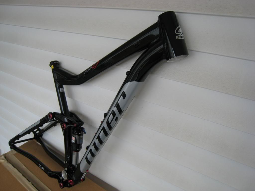

My RIP 9 frame arrives at the bike shop. Got the next two days off to spend building it up and testing it out. large frame weighed in at a hair under 7.1 pounds, complete build according to my spreadsheet calculations should be right about 31 pounds. Hopefully it'll be a bit lighter in real life.
The build:
Licorice RIP 9 frame, large
Rockshox Pike fork, 140mm
SRAM X9 10 speed shifters, Type 2 rear derailleur, 11-36cassette, X7 front derailleur
SRAM s-1250 crankset off my Stumpjumper, 22/33
Hope Tech X2 Special Edition brakes, 183mm
Hope Pro II hubs/Stan's Arch rims
King headset
Hope 90mm stem
Niner alloy flatbar, 710mm
Thomson dropper post
Ergon GP3 grips
Maxxis Ikon 2.2 rear, Schwalbe Racing Ralph 2.25 front
Specialized Henge seat
