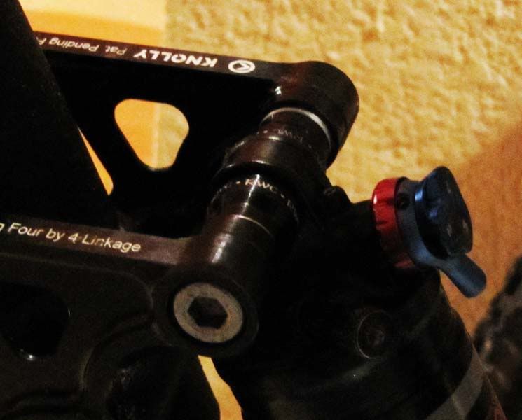

I installed yesterday needle bearings for my RP23 and the Enduro seals for the Lyric.
I also inverted the shifter/brake levers.
Here are some pics...
1 - 20 of 32 Posts
Second ride on this setup.
It's pretty nice, small bump compliance is a little better (hard to improve something on an already awesome bike), and I think that the bearings did pay off. It's not night and day difference, but still something pretty good. It's nice to ride on a magic carpet on the trails.
The enduro seals haven't yet broken in, so there is still some fork stitchion, but not as noticeable as the first time. I hope that by the next ride the stitchion is gone, so I cannot say much about the enduro seals.
The change in lever / shifter position seems to be working fine so far, probably I will keep it, maybe just move the brake levers a little closer.

Where did you pick up the needle bearings, how much were they?
Needle Bearings for Endo
Hey AB,
I recently installed them on all my bikes including the Endorphin. You can order them direct from RWC website http://www.enduroforkseals.com/.
You will need a lot of the 0.5mm size 8 spacers they sell to fit your Endorphin upper rear shock connection. I sourced some other washers to space the upper shock connection. If I remember correctly it takes 3mm per side on RWC's 40mm needle bearing kit. The lower connection is a perfect fit for the 22mm needle bearing kit with no washers.
I have the tools to press out the old bushing and install the needle bearings.
The service will require beer, but not IPA :nono: , which seems to be a fav of our local MTB crowd.
HoJo

I bought 4 sets of shims, so I have 4 0.5mm shims on each side.
I put an RWC kit in the upper mount only, makes a small difference, hopefully the wear life will be longer than the bushing. I doubt installing one in the lower mount will do much.
