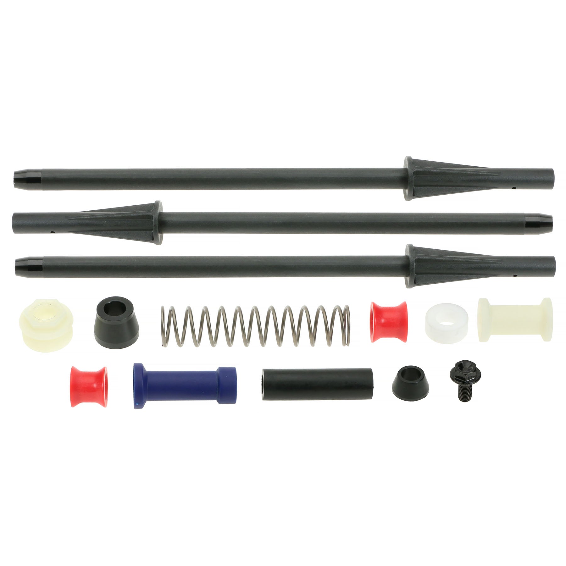

- For pressing in seals, are there any disadvantages / advantages to the Manitou press vs. one of the piloted seal press designs like RWC sells?:
RWC DUAL WIPER-SEAL PRESS 32-34

As for some of the other questions: do you have a preference between the Manitou vs. the RWC seal press? I see you sell both on the Shockcraft site and they're roughly the same price.
12,550 Posts
That's kind of what I figured.
We use the RWC presses. The Manitou one we should probably obsolete. It was good for the non-flanged seals.
