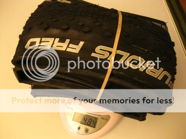

Schwalbe favorites
Heres my Schwalbe favs..
Rocket Rons front and rears during the winter and wet months
Racing Ralphs (rear) and Rocket Rons up front- during Spring
Furious Freds (rear) and Rocket Rons up front during the summer :thumbsup: (my fav)
Furious Freds all around for bragging rights :D
