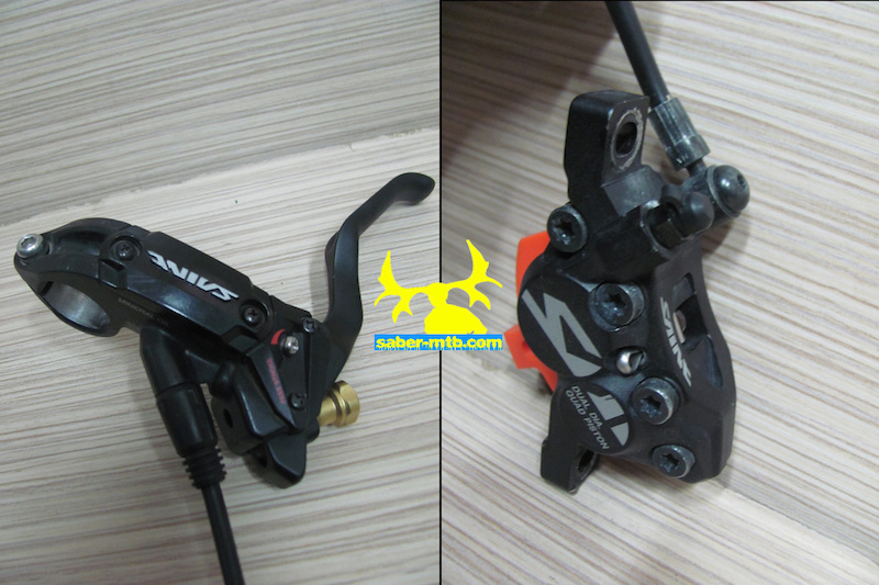

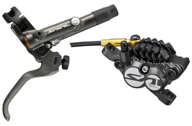

I was wondering if pads for 2011 Saints / M 810 /
and the new 2012 and newer Saints / M 820 /
can be used in each other....???
As if seems they both look like the same and the new model only has heat sink fins.............
Are they actually the same size or have minor differences in the shape and size ??

The new finned pads are put into the brake from the top, they are not compatible with the old 810 model brake.
Non finned pads that are used in the 810 model will fit into the new 820 model.

Thanx For the info Bro.....
So the pad / padded surface / tham selves are the same...........and their width is like each other......and as you mentioned i can use the 810's pads in the 820 's.......But not vise versa......
