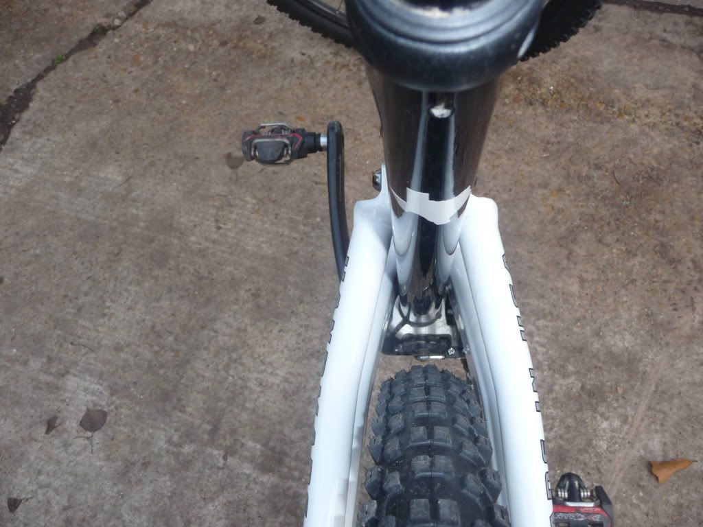

found a 07 swing arm (without brace) and ordered a new wheel set - Stan's 650b - kenda nevagals 2.3 front, 2.1 rear
Bike weight before 24.7 and now 25 .00 real happy with this, I thought, It would have been more.

Do you think at 2.3 nevegal would fit in back? I would like to put 2.3 front and back on my rush.
i think it would be to close for my taste. if your rim was true, tire was mounted perfect then it may work, but it will leave no room for minor tweaks.

Would you need the older Rush swingarm to do this, or could it be done with the standard '09 swingarm?
If your swingarm has the cross brace, its to close. Some have simply removed the brace?? I was lucky enough to get a 07 swingarm without the brace and swap them. I then sold my original swingarm to recoup some money. I fell better having a swingarm thats not altered. There is not a "real" weight difference between the two, i was told 100 g. When everything was apart i put both on a scale (hanging style) and it didn't show a difference.
If the nevegal 2.3 doesn't fit well in the back I may just stick with my 26x2.35 back there since it isn't much smaller in diameter than the 650bx2.1.

Have you tried fitting anything wider than 2.35 in the back?
I mean what's the widest 26" tire that could fit on a Rush. (lateral clearance would be the issue since you can easily remove the brace tabs)
