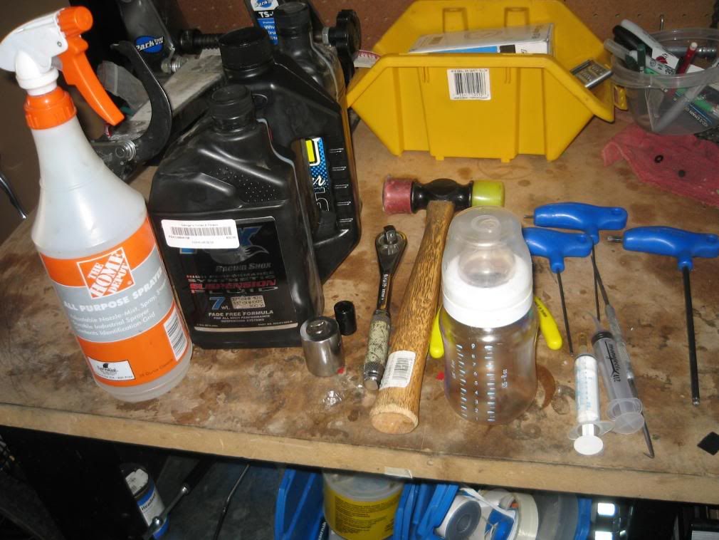

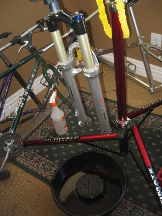

Step 2- Get your tools ready. The only special tools that you really need are some snap ring pliers and the shock oil (SRAM 5wt for the damper and whatever shock oil you have for the lowers- I used Fox 7wt). Some synthetic motor oil like Mobil 1 would work for the lowers as well.

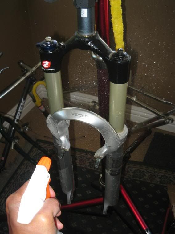

Step 3- Clean the fork thoroughly

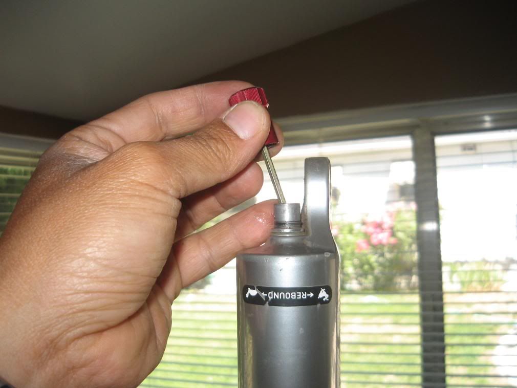

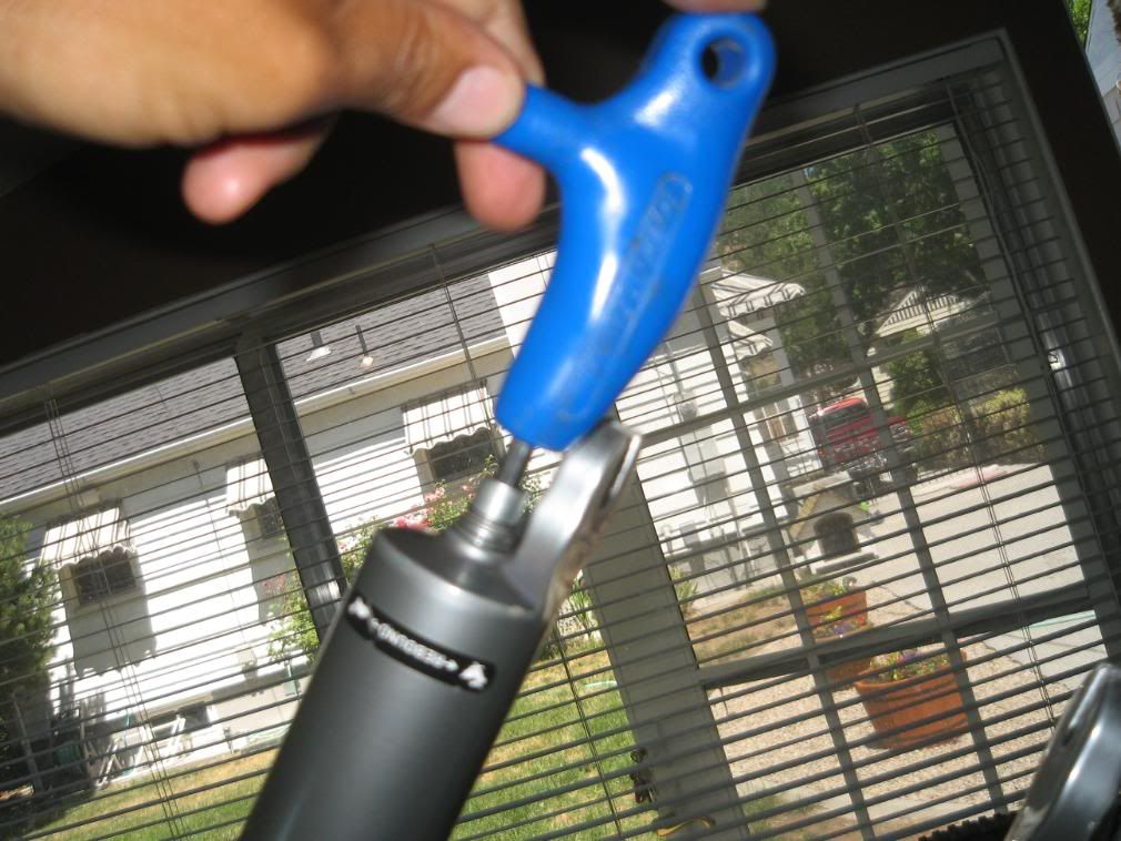

Step 4- Remove rebound knob, air valve covers and release - and + air (negative first, positive second).

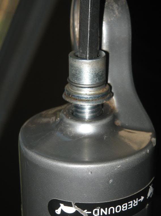

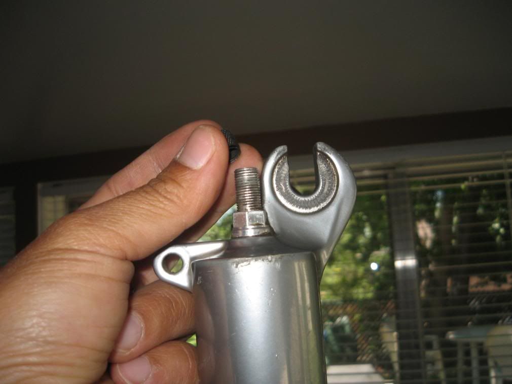

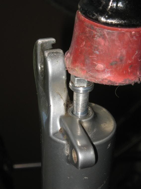

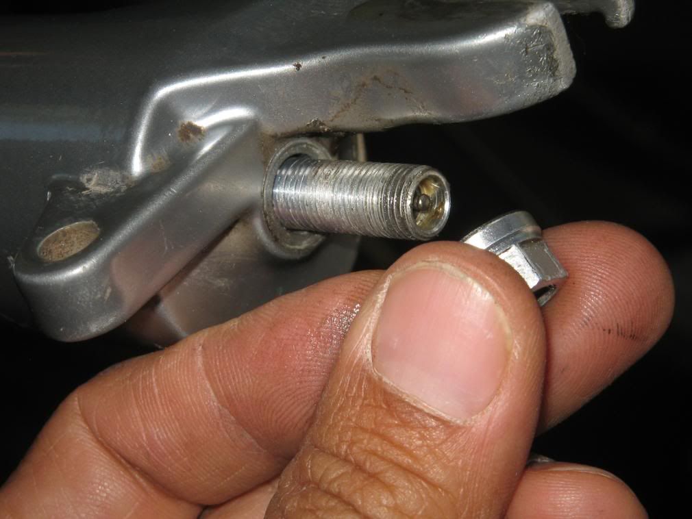

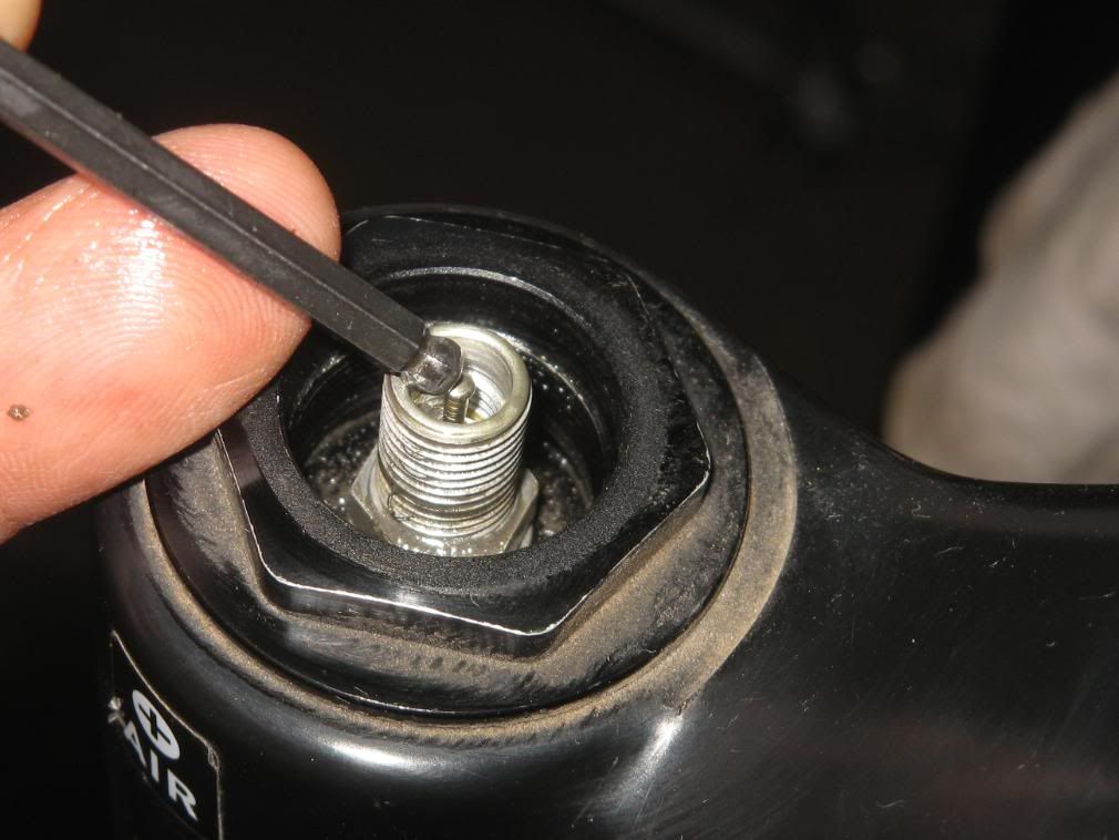

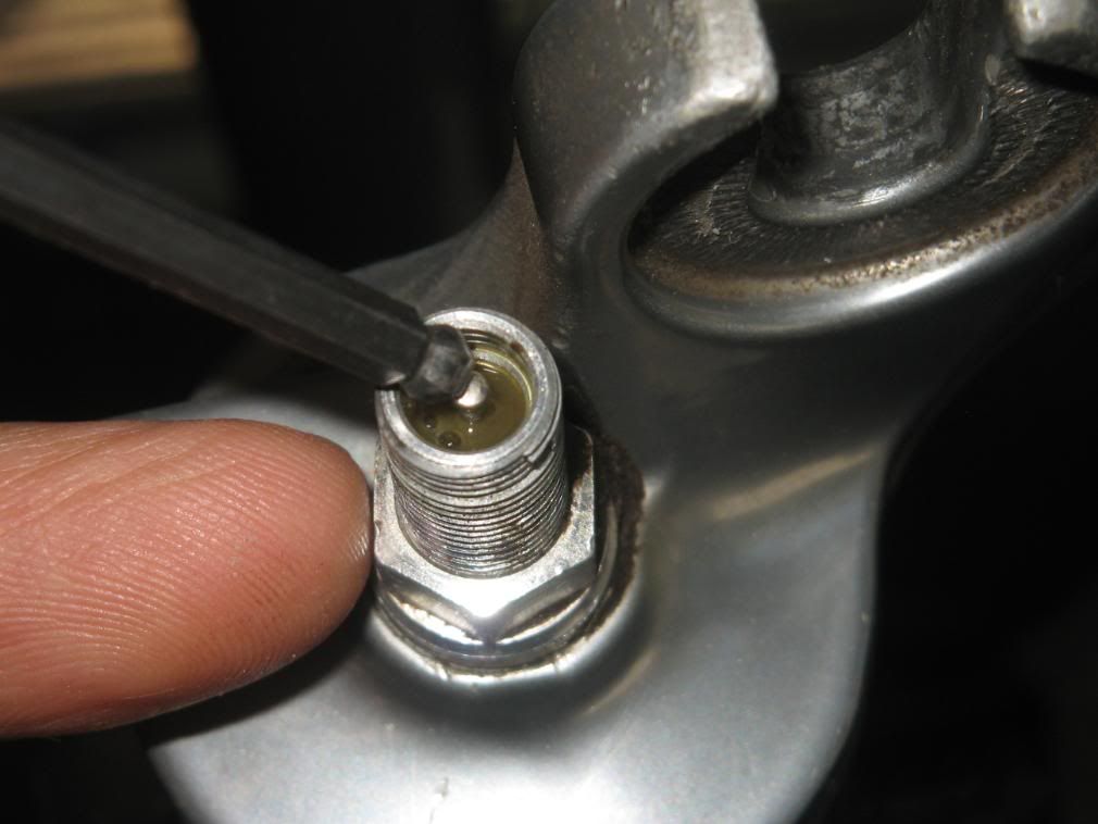

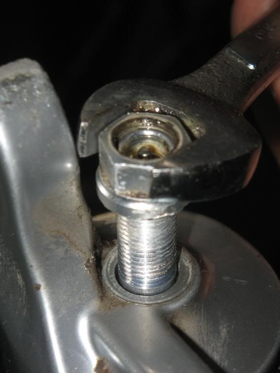

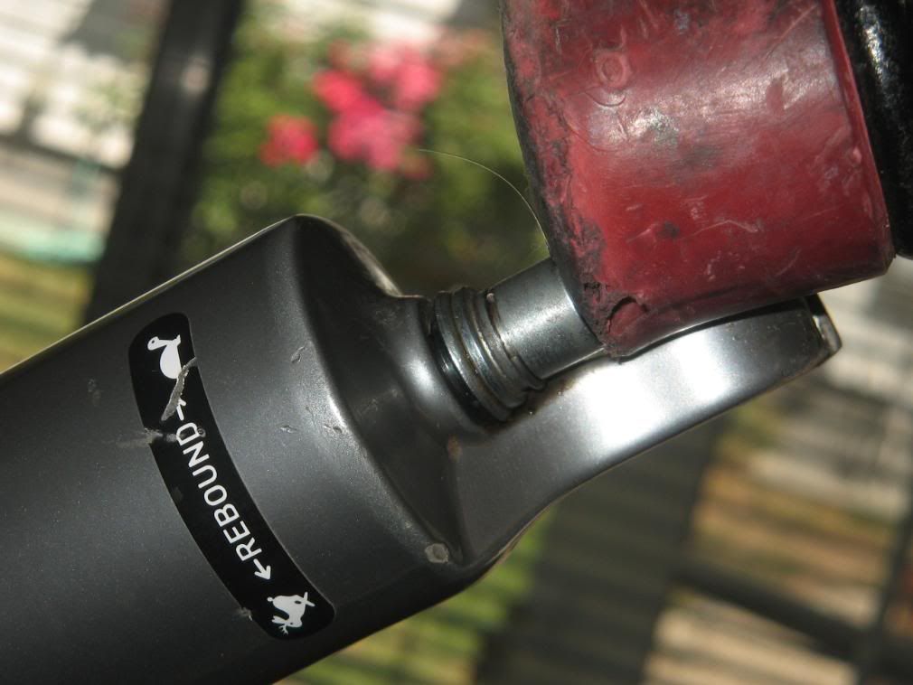

Step 5- Unscrew damper side footnut using a 5mm allen (3 or 4 turns). Using a 10mm open ended wrench, unscrew the air spring side footnut until the bottom of the footnut just goes past the rod.
Tap both sides with a rubber mallet until you feel the rods release.

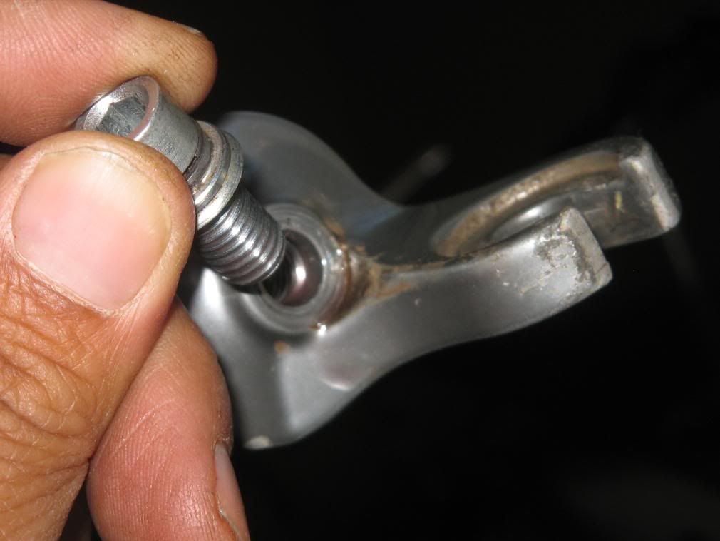

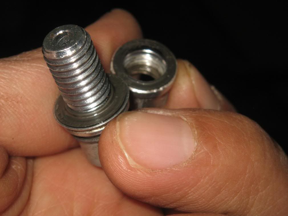

Unscrew the footnuts by hand, making sure you still have the black crush washers (and that they are in good condition).

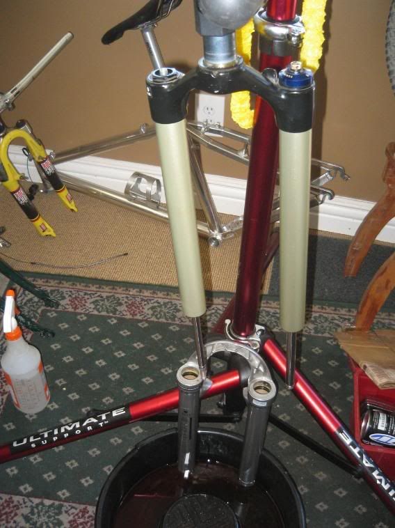

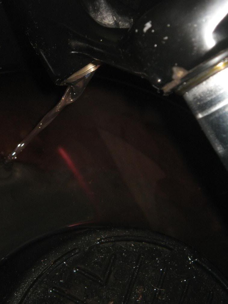

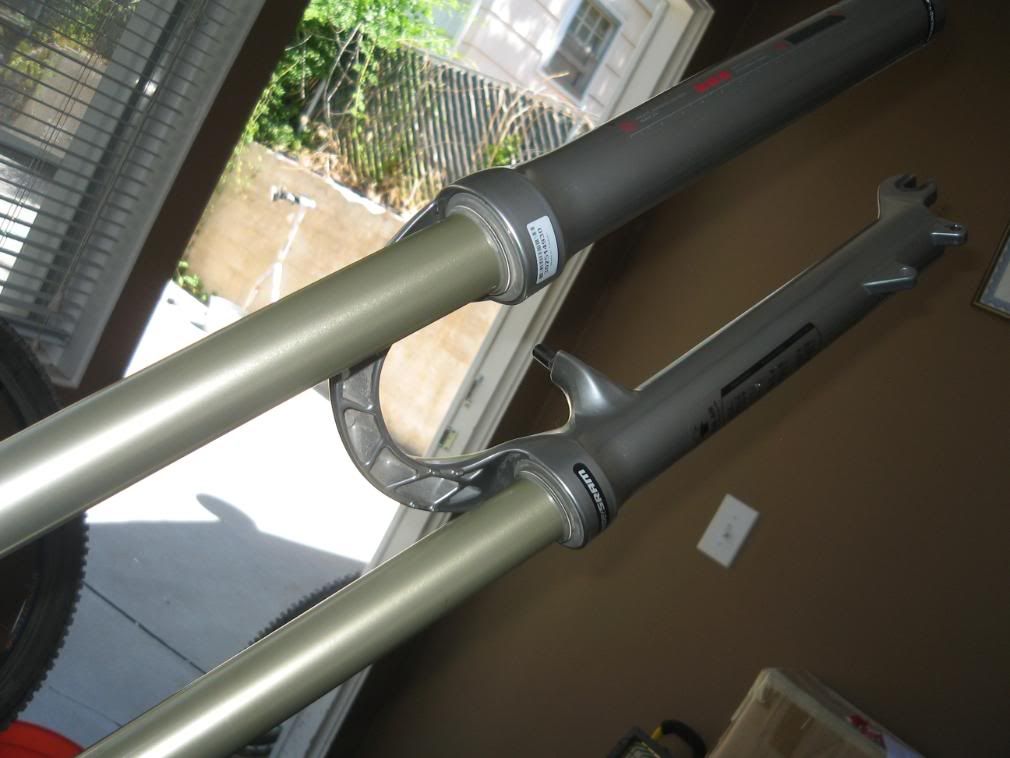

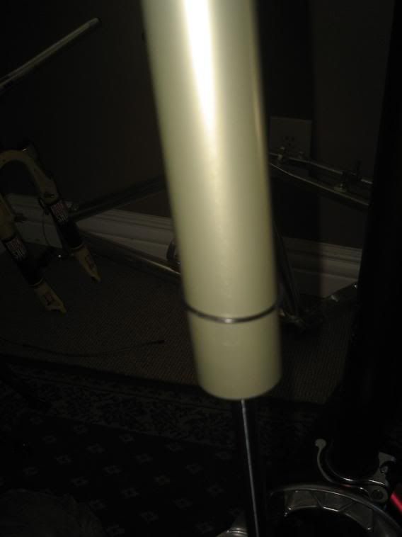

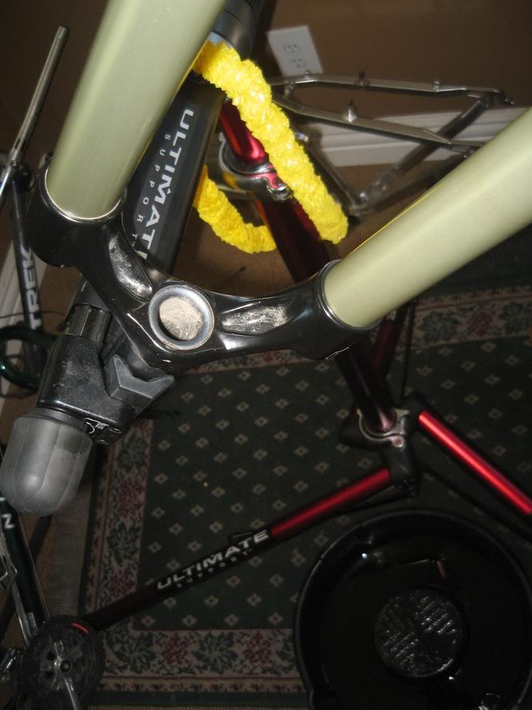

Step 5- Pull the lowers off the uppers and let it drain (mine had hardly any oil in the right side lowers).
I typically let the lowers sit in the bucket for a few minutes to completely drain the old oil.
Optional Step- Add an O-ring to either stanchion as a travel/sag indicator.

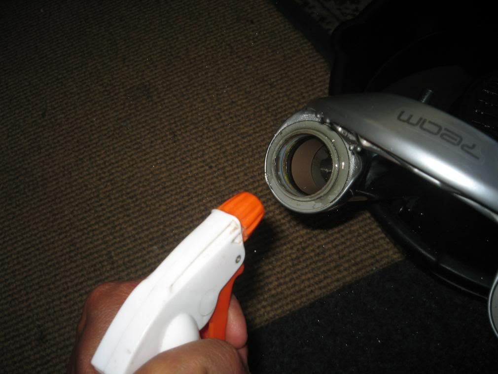

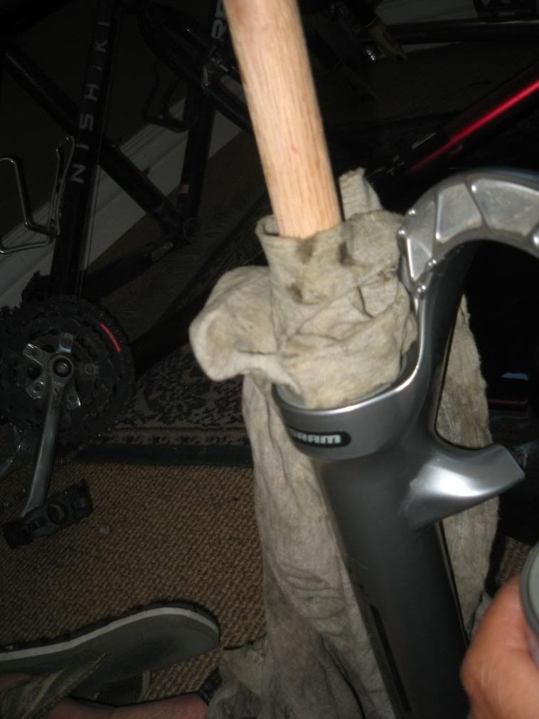

Step 6- Clean the lowers and stanchions using rubbing alcohol.
I use a little wooden dowel and an old rag to wipe off any excess cleaner/oil from inside the legs.
Optional Step- Remove the foam rings from in between the oil seal and lip seal. I find that these foam rings get wedged between the oil seal and stanchions sometimes creating more stiction. You can easily pry them off with your fingers.
Inspect your oil seals, bushing and lip seals. Replace as necessary (I highly recommend Enduro fork seals).

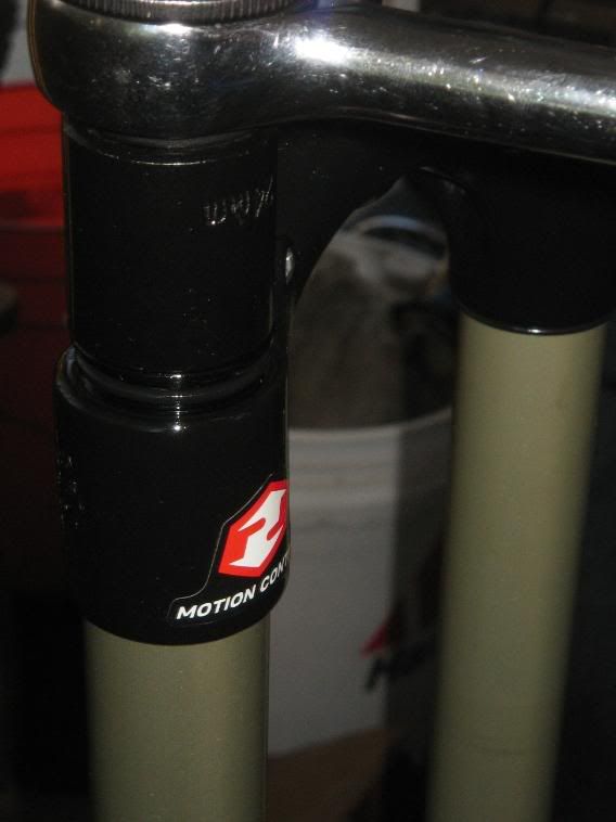

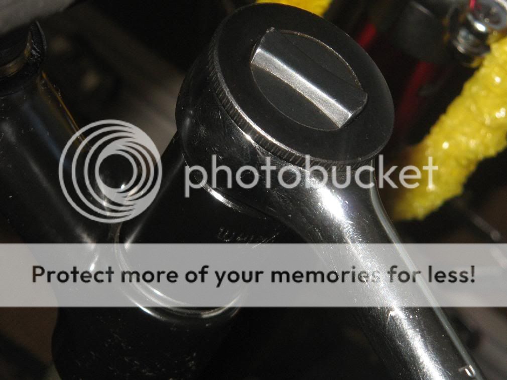

Step 7- Remove the top cap on the air spring side using a 24mm socket (I use an impact socket that you can get from any auto parts store since it has no bevels).

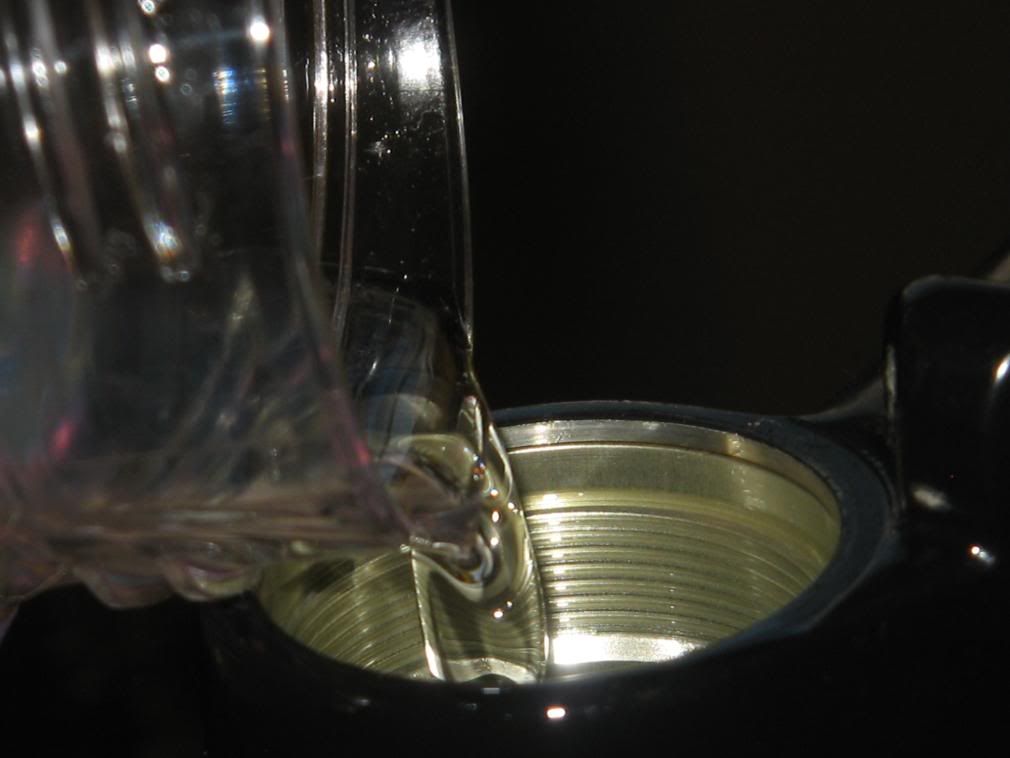

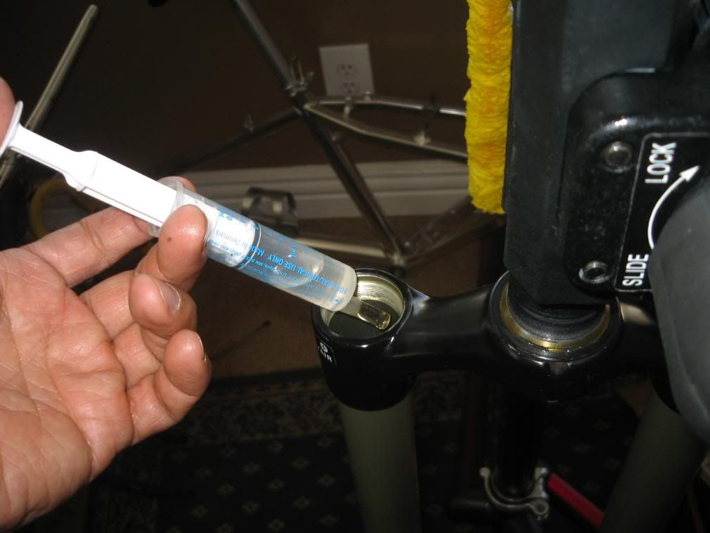

Let the oil from the air spring side drain into the oil bucket.

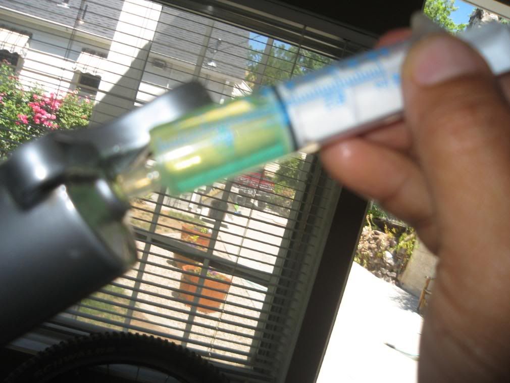

Replace the oil with new oil. I used 5ml of 5wt shock oil.

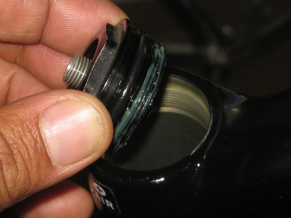

A slight coat of grease on the threads of the top cap before the top cap back on. The top caps and footnuts are all torqued to 60 inch pounds (except for the spring side footnut which is threaded on until tight).

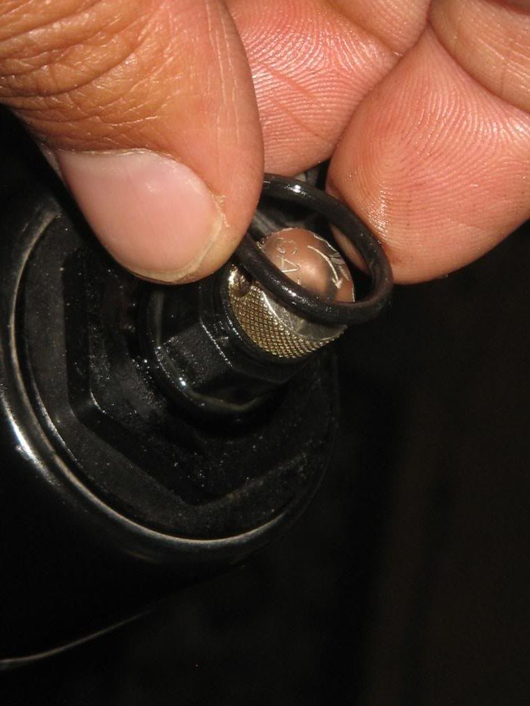

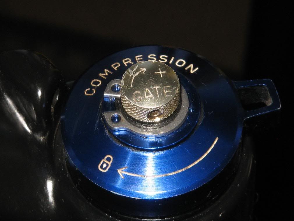

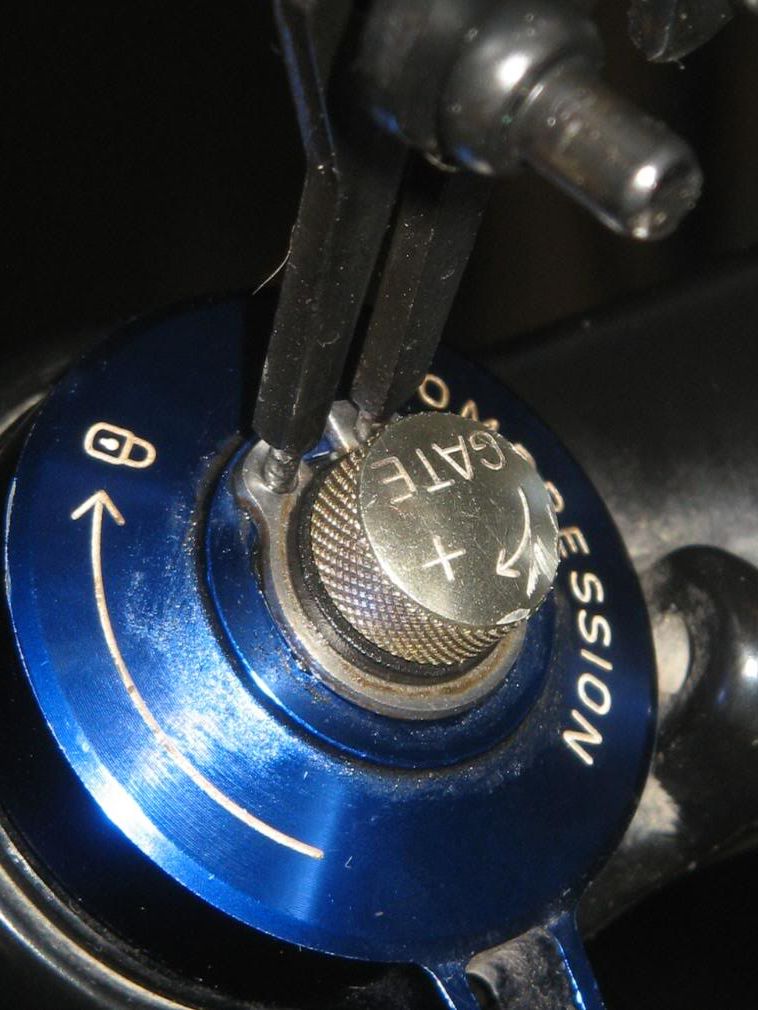

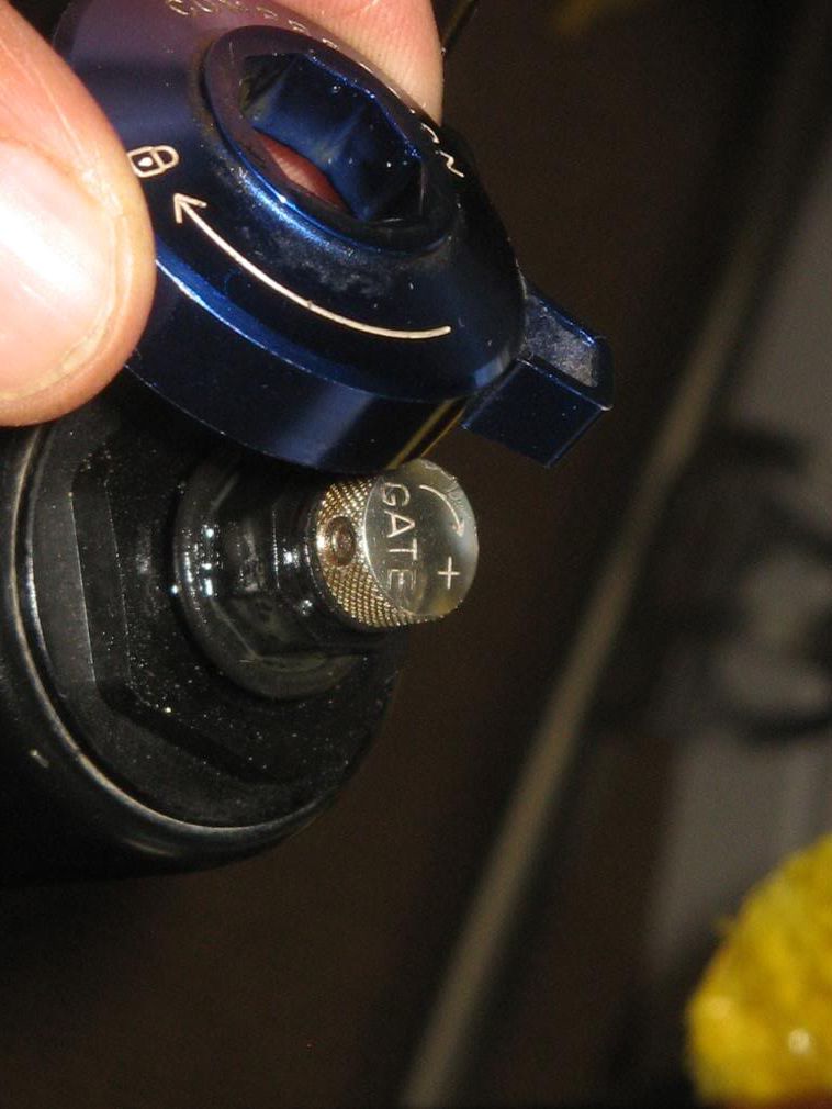

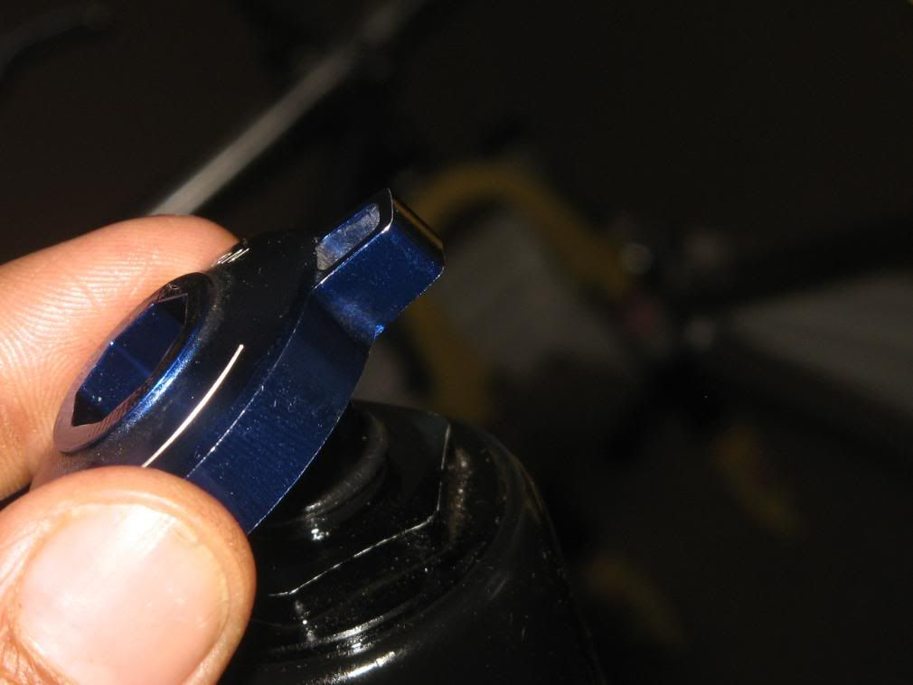

Step 8- Remove the snap ring off the top of the compression knob.
Remove knob and O-ring.

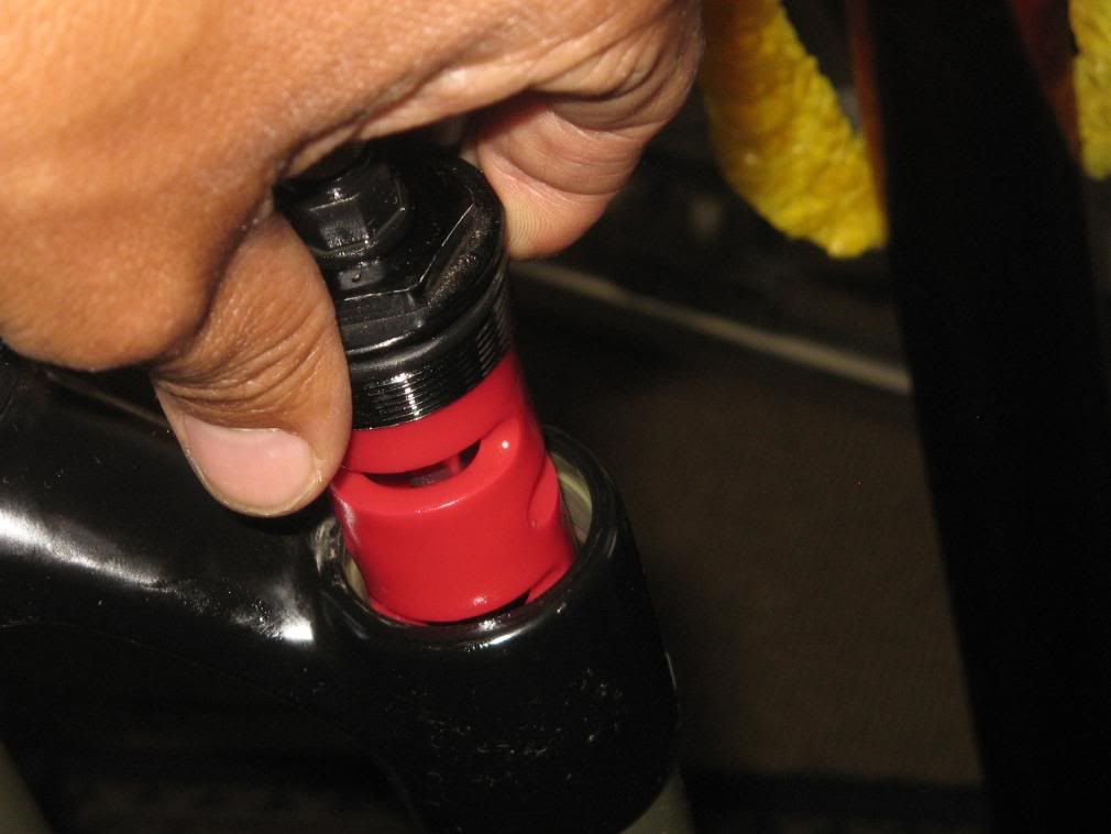

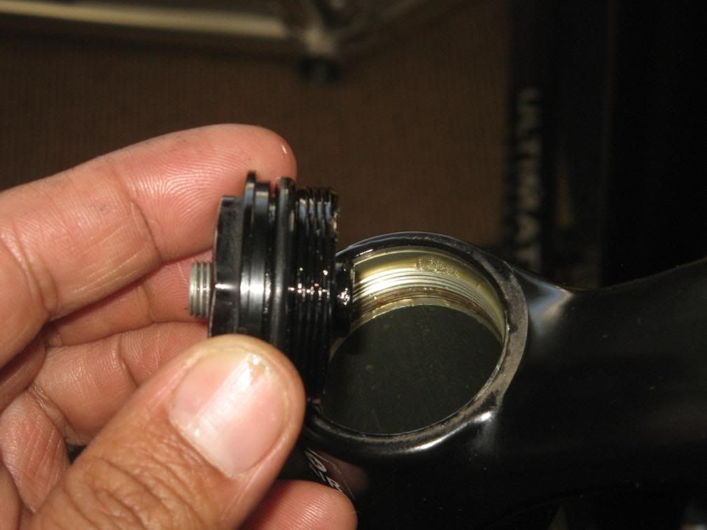

Use a 24mm socket to remove the damper side top cap.
Carefully twist the MoCo cart out

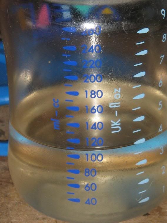

Drain the oil on the damper side (it's perfectly OK to re-use this oil if it's clean so you may want to drain it into a clean container).
Replace with 110ml of SRAM 5wt shock oil (115 for a 130mm Rev and 120 for a 140mm Pike). This isn't the most accurate container measurement but I'm thinking it's close enough...

Thread top cap back on and install the O-Ring, Compression knob and snap ring.

Tighten both footnuts making sure that the crush washers are between the nuts and the lowers.
