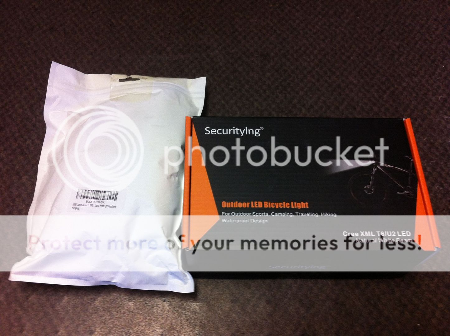

Just received my HD-016 "SecurityIng" version from Amazon. Battery had enough juice to run through the modes one time before it died. Will test it out later. First impressions is that it looks good!
(That's my SSX2 package on the left.)
The box is just a generic bike light box. It says "XM-L" and "Natural White" which are both lies. It came with cool white XM-L2's.
BTW - I also received my SolarStorm X2 from Amazon. It did come branded as an X2 and not blank (I know that doesn't mean much, but I like to see it branded). First impressions on it - doesn't seem very bright on high. More testing and teardown on that one to come too, though I won't post it in this thread. No promises though on when I'll get to tear downs.
-Garry
