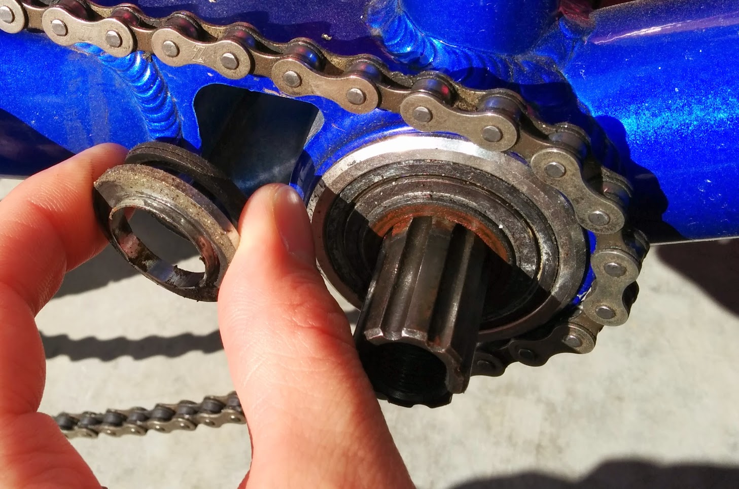

I have a 2001 Schwinn Pro Stock Team that I bought to ride around with my kids. Youngest is getting into BMX, I think I'd like to try it too. Nothing really competitive, just have some fun.
I have this irrational fear (maybe rational) of my chain coming off and going over my handlebars like I did when I was a kid, so I'd like to replace my chain. My front sprocket looks pretty chewed up (recall hearing I shouldn't put a new chain on a beat up old sprocket), so I would like to replace that too, but I'm not positive with what?
My cranks have 8 splines. My sprocket just has a hole, no splines.
On a related note, is there a difference between a KMC Z510H and Z510HX?
Just trying to figure out what my options are. Any links are appreciated. Thanks.

I did some more measuring.
On the spindle, the outer edges of the splines measure ~22mm diameter, the inside edges of the splines measure ~19mm diameter. Would that be a 22mm I assume? The hole itself in the sprocket measures ~24mm but it could be smaller.
I found a couple sprockets but they are 3/32". It appears I should be able to get away with running 1/8" chain on a 3/32" front sprocket (1/8" rear still).
I believe these are my options so far:
https://www.danscomp.com/products-PARTS/457051/Poverty_Econoline_Sprocket.html
https://www.danscomp.com/products-PARTS/457068/Profile_Imperial_Sprocket_36-46T.html

Hey Dave, that style sprocket is pretty much obsolete in the bmx world these days. You shouldn't have much trouble finding a nice old profile sprocket on eBay or check danscomp.com. They are likely to have something.

Thanks! Yeah I've found doing more reading than I should have on this, they've pretty much moved to a cassette rear hub w/ 9t, and 25t up front. Pretty much the same ratio. I actually found what looks to be a halfway decent one over on PorkChopBMX, let's hope it works out! eBay does have a lot too.
