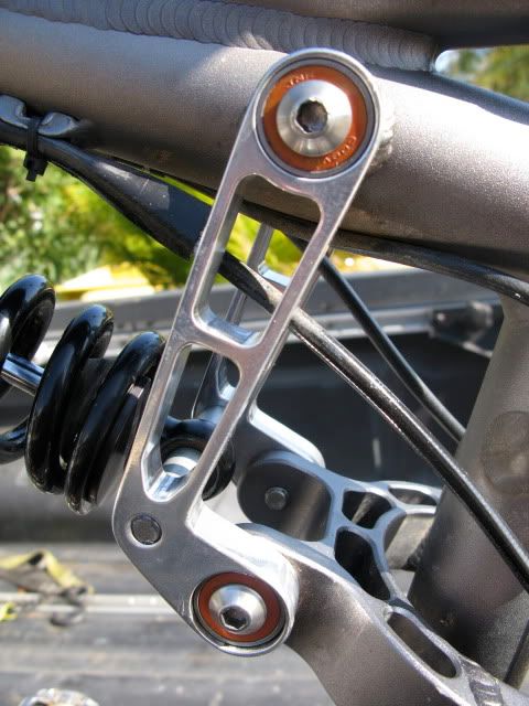

Here a couple of pictures of new XCL links from Chumba. These are prototype, and I'm not sure if the swinglinks available are similar or same. As you can see they are quite nice looking and they slackened my bike about 1 degree, maybe a bit more.
If your interested, the headtube my XCL with a Wotan at 160mm and the new swinglinks measured out at 66 degrees. I used an angle finder I bought at Lowes, so I'm not sure of the accuracy but it states that it's accurate within 1/2 degree. Take it for what its worth.

Very nice looking. What shock are you running on that XCL? I keep toying with changing to a coil sprung shock.
I thought that for every 20mm of fork travel, it slackened out the HA 1 degree. So, by running a 160mm fork you should have gone to 67 degrees from 69. Maybe that swing link slackened another degree?
who, what, how and when can I get those!!!!! I have an email to Alan about the Gen 2 links as well. I'd really like to lower my bb a little
Aesthetically, these look great! How much does this lower the BB compared to the stock link? Is any travel sacrificed by using this swinglink?

If there's enough demand I can have them machined - one of our customers Max made them. I also have some one-piece swinglinks we've designed in Solidworks - we are thinking of machining a few samples.

Alan told me that they can only be ran w/ a coil...not 100% sure why just yet, but I'm sure we can get to the bottom of it.
That's another expense that I didn't want to take on, but it might just be worth it!
I will talk to Max - and see how much he will charge us to have some made.

same here, i'll have a few :) Am i right in saying that they can only run with a coil shock?
The lower setting or shock position should use a coil - as the suspension seems to react much better to coil shocks in that setting -

Here is a very belated pic of my XCL with the custom machined swinglinks.

Thanks - those look great!

THAT LOOKS FREAKING AWESOME! I GOTTA TRY IT! But now I guess I need to come across a coil shock
