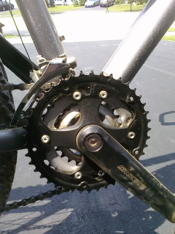

I completed my first ride today and had some troubles with my outer chain ring hitting a few logs while passing over. I looked online to see how to remove it and replace it with a bash ring, but when inspecting the bike found that the rings are actually riveted together. I would like to switch to a single ring for simplicity and ground clearance. I realize that Suntour is the bottom of the barrel, but I am willing to upgrade if need be.
What are my options here? Do I need a whole new crank setup?

Cheapest solution......file down the teeth on the big ring and voila...instant bashguard.....more expensive solution, go out and buy a new crankset, bottom bracket, and bashguard......
I hadn't thought of grinding it down, haha. I was looking around Jenson and came across this:
http://www.jensonusa.com/store/product/CR298A05-Truvativ+Stylo+22++Gpx+Crankset+08.aspx
I'm not really sure what sizes I should be looking for...
Your bike has either a 68 or 73 mm bracket that crankset will fit both using the included spacers.......
If you are gonna do it yourself you might need a BB removal tool (not sure which one)......or else take it to a bike shop.....
Either way add up $154 plus shipping plus the cost of the bike plus the cost of tools/installation.....you probably could have spent a little bit more for a bike that already had a 4-bolt crankset saving you the trouble.....
After thinking it over, I will just ride the crap out of this for the rest of the year stock and upgrade to a new bike next season. You are right, upgrading this will just turn into a money pit. Thanks for the replies. I should really focus on getting better for now.

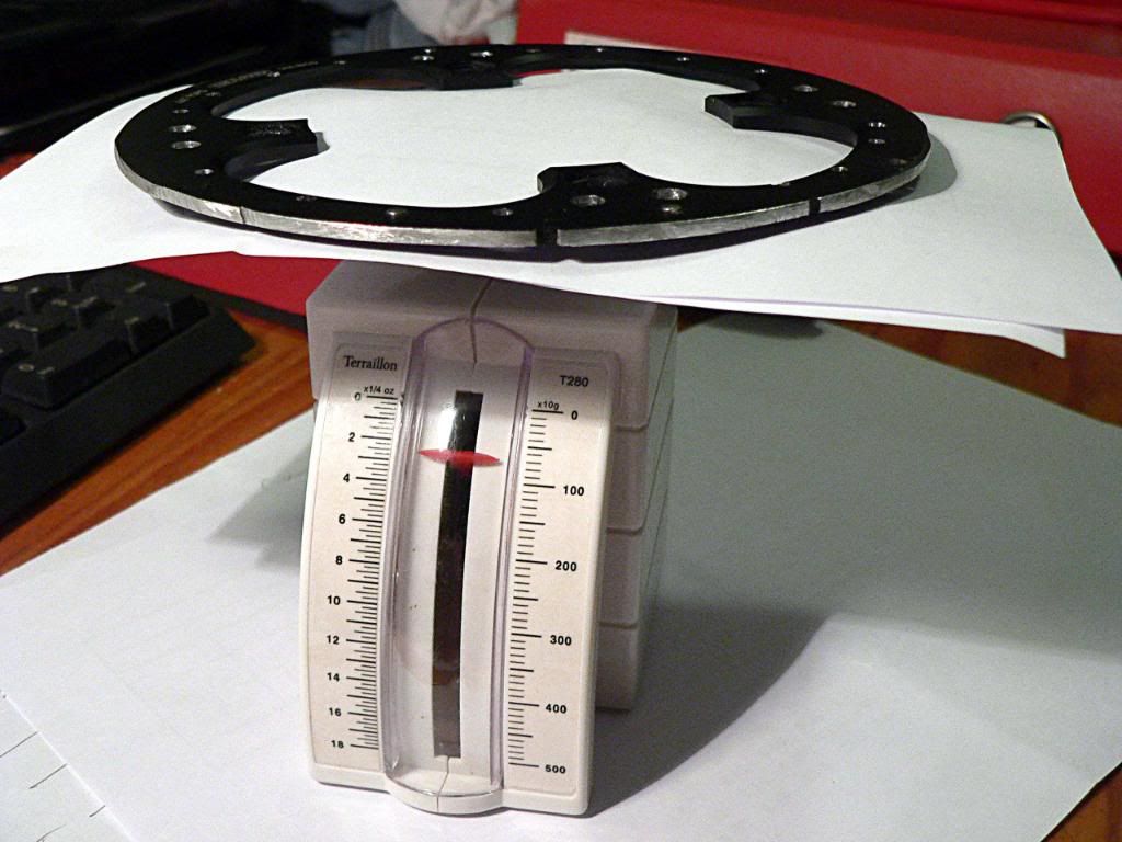

Ghetto bashring
+1 on the DIY bashring idea, suggested above.
  • It's not difficult, and costs nothing but a bit of your spare time
  • Sounds like you probably never use the 44T big-ring anyway
  • So just get out and ride the ring(s) off your bike
  • Then after trying 2x9 for a while, you can always splurge on blingy cranks later :)
Here's a ghetto 'bashie' that I cobbled-up from a trashed chainring on the weekend...
[Edit] I just took a closer look at the OP's crankset. OMG! That thing really is a POS (no offence intended)!
Anyway, that's more justification for riding it like you stole it :).
