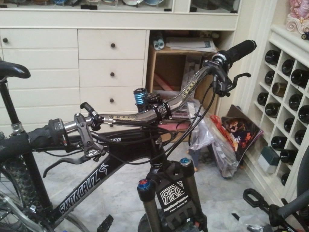

I've decided to try a shorter stem instead of the 100mm I'm using now, but am unsure of handlebar width to get.
Here's a picture of my current setup:
I believe the handlebar to be this model (630mm version):
https://www.fullspeedahead.com/products/214/XC-190-Riser
I'm 5'4" and ride an S size Santacruz chameleon with 140mm fork. I guess my riding style could be put under "AM".
I did some searching and have come across threads where people upgrade to a wider bar and still find themselves wanting more (*looks at mimi*, lol) and would really appreciate your thoughts. :thumbsup:

Longer stem, narrower bars. Shorter stem, wider bars. Seems to work. Look for bars that are 1.5 to 2 inches wider. Well for your size maybe .5-one inch wider.

I haven't got to buying it yet, will get getting it same time as a new handlebar. Sorry for the confusion!
680mm looks nice now. If it's too long I could cut it down like dkbikes4life said.

I was given the same advice (too sudden jump in stem length). LBS told me to get 70mm after telling them the local trails I go to. 710mm handlebar, so I can cut down if I wanted to.
I could only choose from shiny blue/purple/gold/silver and ended up with plain old silver. Whatever I guess! :thumbsup:
Need to get new spacers because the current ones are not enough.
