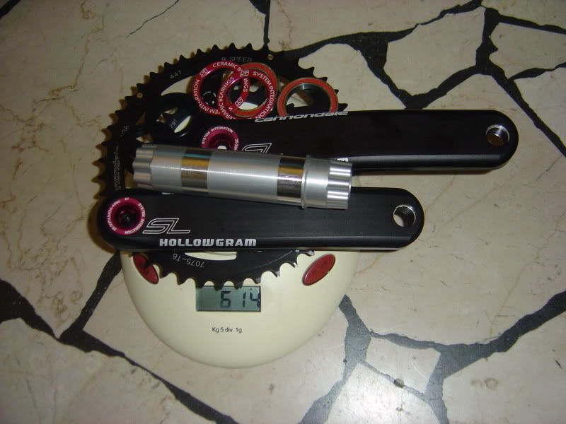

Right now, This is my first choice of cranksets. The Cannondale Hollowgram SL, 2x9. Weight: 614g

Question? Does that 614g include BB weight?​

Thanks Jake. If you Hammer at 210lbs, and they feel good, there going to be great for me, at 163lbs fully geared!!!:thumbsup: Looking at the picture closer, the spindle is on top.

It was on a buddies Scalpel so I'm not sure if he had changed anything on the crankset.
But none the less it performed without issue
I run a RaceFace NEXT Carbon with ExtraLite GARA rings. XX front dérailleur and a KMC X10-SL chain.
^^^Without BB^^^
