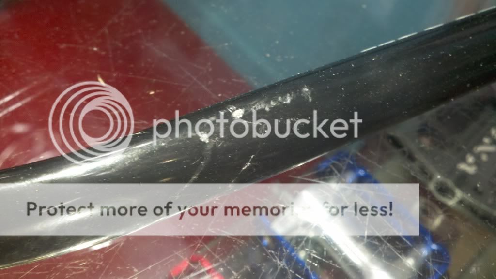

Right off the bat…TERRIBLE finishing work right out of the box. Dimples all over the place in the power coating, scratches down to bare metal on the chainstay, and no prep work done. Had to get the bottom bracket faced and chased (Misfit installed the headset, so I didn't have to deal with that), and the fork…the brake tab was way off square…my shop had to remove quite a bit of metal to get it square, the crown was so roughly machined it still had paint on it, and the hub spacing on it was around 103-104mm instead of 100mm. Keep in mind this is a $925 handbuilt frame and $275 handbuilt fork. This work would've cost me $85 at my shop, but they felt bad for me for and gave me a good discount on the work.
So, I'm mad, but calm. I contact Misfit. He basically says it's too bad on frame prep...even thought they provide it on their cheaper frames at no charge… and the fork is within tolerance. He does tell me that they have received a few complaints about bad powder jobs, and that the powder company admitted to rushing it...so they'll offer me an $80 refund, which I thought was fair enough for a reimbursement.
So…moving on, I build the bike up...take it for a few short rides...3rd short ride on a switchback, the top tube snaps at the head tube weld. I didn't get hurt at all, thankfully. I'm calm about it, while my friends and everyone else I pass while carrying it back are pretty much pissed off and in disbelief. My thought was **** happens, and Misfit will take care of me. Sent a photo with details of what happened that night, and ask him to call me.

Aren't these the frames with the top tube mitered and tig'ed back together for standover clearance???
I try to stay out of these matters, but seeing your failure threw up a red flag and reminded me of the sample frame on their blog way back when. No need to introduce heat and stress into that area, plenty of other ways to make the bend while maintaining the integrity of one complete tube.
This may not be the direct cause of the failure, but I'd be interested to see the butting specs of the top tube and see the wall thickness at all three mitered joints along the top tube...could have had the wrong tubes spec'd to begin with (you said they replaced yours with a heavier wall or something) or accidentally flipped the butting profiles around during fitup and welding (thin walls at the st and ht, thick wall at the middle miter).
I doubt they would use an OX butted tube as the top tube because it would be difficult to weld the thin section of the tube safely and effectively, but...they state on their site that TT OX Pl. is the material and don't specify exactly where. Most builders use a blend of different tubing throughout the frame as not all TT products are drawn in all configurations (cs, ss, st etc...) and it would be a strange occurrence if a rider's weight and riding style called for all of a specific product line. It's been a while since I've ordered from the TT distributor, but I remember avoiding OX Platinum because of the thinner end butting on the range of tubing and went with a more "normalized" Verus and Verus HT tube that came in a heavier 9/6/9 butting profile and larger OD. I would most definitely have employed this same thought process if I was spec'ing a production run of custom bikes to cover the wide range of riders weights and styles and surely as f%&* would use a straight gauge 4130 tube for that top tube design.

It looks like the butting on the TT was either cut off or not long enough and the tube snapped where it tapers at the butting. If this is the case then it would be a manufacturing error not a material defect. (This would explain why they cut out and replaced the TT a second time).
