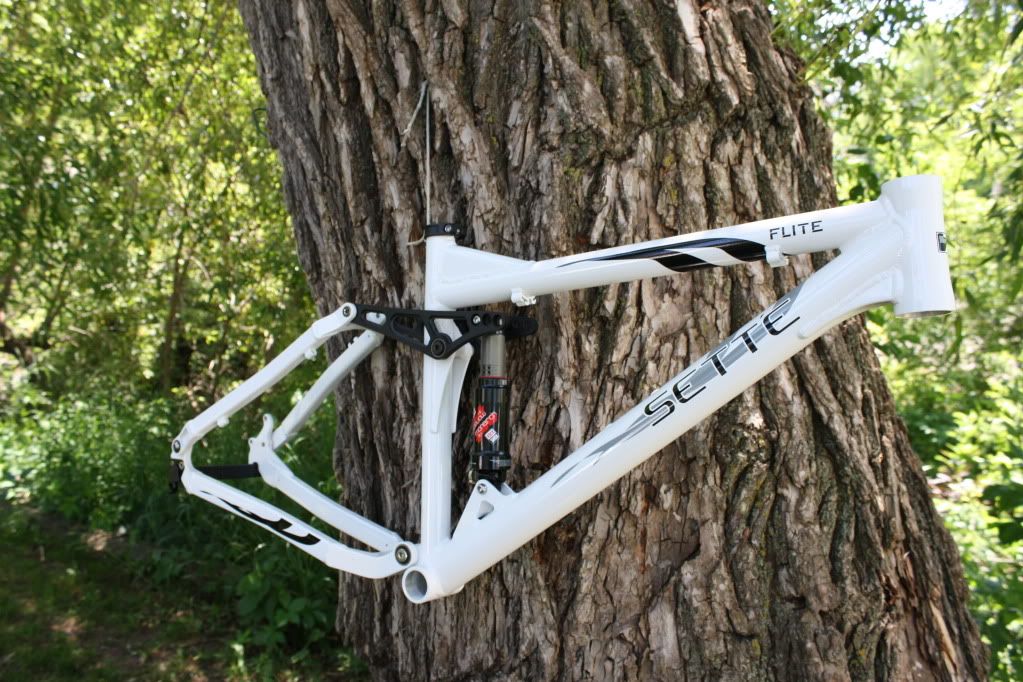

The plan goes something like this... Build a bike over the winter, for AM/some FR stuff next summer... Of course thats just the "plan" and they tend to change a bit over time.
BUT, I have started to move in that direction! I'm starting with a somewhat cheap AM ::Frame::
It got here today (7-12-10) so I thought id get this thread going, and I can add to it over time as the mailman brings me more and more goodies.
So far whats on its way:
Frame: Sette Flite
Pedals: Nuke Proof Protons
Seat: Nuke Proof Plasma
And thats all ladies and gentlemen for the first post! lol. I'm in the market for a 160mm fork next and the rest of the parts will be ordered as I have the money/find good deals used or new. Ill update with actual build pictures once theres something fun to see :thumbsup:
P.S. Suggestions are very welcome, and so is constructive criticism, but please keep the flaming to a minimum :) this is my first MTB build-up

Dunno.. Thats how it came out of the box. Does it matter performance wise? I'll flip it regardless... but just curious.

performance wise i dont think it matters but having it flipped like that you are a little more likely to gunk up the seals (due to gravity).

Sette does this IIRC because the linkage at the top can make getting at the shock adjustments kind of hard. The linkage has different holes for differing amounts of travel and on specific ones the shock adjustments can interfere with the linkage.

It doesnt affect performance. I know on some bikes they have it a certain way because it simply won't fit the other way. It may have some clearance issues with the fulcrum (yes, I just said fulcrum), the place that the suspension link is connected to the frame.

Performance is the same for both shock orientations.
It's flipped so the frame does not snap the swivel air valve. Flip it so the valve is at the top if you want to get dirt from getting in and staying in due to gravity. You can still access the valve. Just use a rubber band so it doesn't move while riding and gets caught in the suspension and snaps.
The Monarch is a nice shock. I like my 4.2 and don't plan on switching it out. For a bombproof 160mm fork I recommend the coil Domain 318. Very tough and not expensive.

Thanks for the reco Dictatorsaurus! I appreciate the input. Ive heard mixed reviews about the 3.1 shock... actually... mainly all bad because of some factory defects, but its covered under warranty, and ive heard most of the time SRAM will end up upgrading you to the 4.2 if you have issues, so ill have to see. I only ask on the rear shock because im about 200lbs and wasnt sure if it would handle that kind of weight. Ill check out the forks and cranks.. Thanks again!
