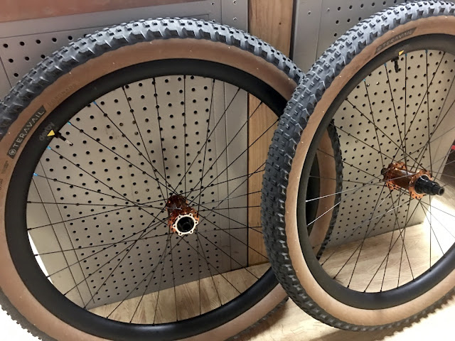

I've ridden DT Swiss hubs -- pretty much exclusively -- for a few decades. Every event and training mile in my competitive career was ridden on DT hubs. Probably 90% of the miles I've covered since then have been entrusted to them.
I chose them because they were so light, so simple, so durable, so easy to maintain. And because they so infrequently needed any maintenance.
All of that holds true with their new 240 EXP hubs, which are what I built the 29+ setup for my SlingShot around.
But the new EXP hubs have a minimum of 36 points of engagement, up from the 18t that they've been for decades.
I'm not an engagement snob: For 95 to 98% of riders I don't think it matters in the least. Thus, I was not one of the vocal minority asking DT to increase theirs.
But now that they have, one of the things I most liked about DT hubs -- their near silence when coasting -- is gone. They're fairly loud now, as seems to be the growing trend across the industry.
I cannot abide a loud bike in any way. Noise when riding drives me batty, and is completely antithetical to the reason I like getting outside to ride bikes in the first place.
So after just a handful of rides on the 240 EXP I ordered some Onyx hubs. When they arrived I removed that wheelset, removed the 240 hubs, laced in the Onyx, and here we are.
Easy on the eyes, but -- much more importantly when riding -- easy on the ears.
I still love DT Swiss -- the people and the product. I'm still building at least one set of wheels per day using their hubs. Jeny -- who loves loud hubs as a means of alerting apex predators to her approach -- is still riding DT hubs.
But until DT produces a quieter variant of their Ratchet EXP drive mechanism, going forward I'll be on Onyx.

Silent hubs are so nice. I have a roval branded 240. it's loud. Once you get used to silence it's hard to ride anything noisy. Onyx are heavy AF but worth it because they do a lot more than just let you hear your tires. They remove the clunk that happens with all hubs that have any degree of lag. This clunk is something we are all used to and don't notice because all hubs do it. With enough time on onyx the clunk of other hubs becomes all too apparent. The removal of the clunk we all have experienced is something some find odd about onyx. It like there's a damper in the drive mechanism. You simply can't make it clunk. Some say spongy, soft..... I say it's a thing of beauty. Silence not just when coasting, but when you hammer with all your horsepower after coasting. I've owned a ton of hubs, nothing does this but onyx. I suspect stealth too but I haven't tired one. When ever I ride my roval the clunk is as annoying or more so than the noise. I now feel the clunk vibrate up to my legs. Something I never noticed until a few years on onyx. If all hubs used sprag clutches, the first pawl, start ratchet... hub to hit the market would be immediately noted for the clunk, but because we all know the clunk so well it's just how hubs work so we think nothing of it.

Those Onyx are nice! What colour is that?
I've got a set of classics and a set of Vespers and they both have been flawless. One thing I did notice on my Banshee was kickback when using the classic so I built another rear wheel with an 18 tooth ratchet in a 350 hub as an experiment and sure enough it made a difference with less feedback thru the pedals.
