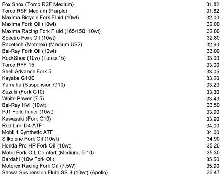

For damper oil, just buy the weight you need at your local motorcycle shop. Use this chart to find the closest weight: https://www.pvdwiki.com/images/a/a7/PVD-ISO-Viscosity-Data.gif

The [email protected] is very similar to most of the 10 weight suspension fluids.
Fox Shox fluid is 31.82 cSt, while M1 ATF is only slightly heavier at 34.00 cSt.
yeah ATF is fine for fork oil...it is typically about 10 weight...hella cheaper
