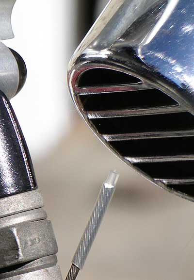

Cut the housing to the approximate length using whatever cable cutters you have handy. Ewww, that's a crappy cut!
Strap on the goggles, whip out the Dremel and a #456 reinforced cut-off disc and go to town.
Make the cut quickly and decisively -- cutting slowly builds heat, melting the inner lining and damaging the outer sheath.
You can use the non-reinforced disc that come with many Dremel kits, but be warned that they shatter easily. Eye protection is a must.
You're left with a nearly perfect looking cut with fringes on the outside and a shrunken inner liner.
With snips or *****, trim the fringe from around the exterior to ensure a solid bead seat.
Use an awl or a scribe to pierce the inner lining and flute it open. Wait for the lining to cool, otherwise it'll just mush around.
Perfecto! Run a piece of cable through the end to check that nothing is plugged up.
As a coup de gras, spray dry lubricant through one end until it spits out the other. This will give you a little extra slickness without an oily coating to attract dirt.
Here I use Pyroil Silicone Spray Lubricant, but other dry sprays such as or [url=https://www.888teammclube.com/frames/sailkote/]McLube SailKote will do equally well.
]As a finishing touch, give the heat shrink treatment to the cut cable end. It's a great alternative to crimping a cable end cap on, it'll stay put, but will easily come off with a firm tug if you need to re-pull the cable.
I find that 1/16" fits great on 1.1 & 1.2mm derailleur cable, and 3/32" is perfect for 1.5mm brake cable.
The 3/32" tubing can be difficult to find. The skinnier 1/16" tubing is available at Radio Shack and fits over 1.5mm brake cables, but will split during the shrinking process if overheated.
You don't need a heat gun -- a lighter or a match will do the trick.
Tidy looking installation.
