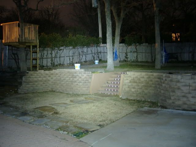

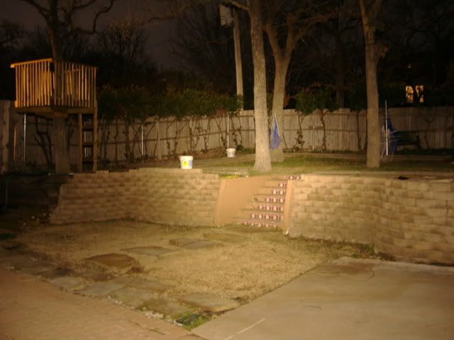

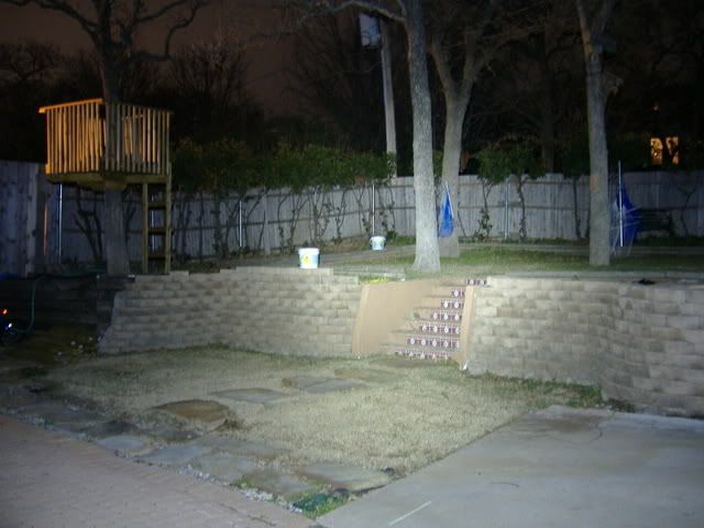

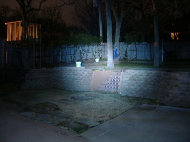

MCE and P7 both using Boom SS
For P7 Boom SS is sanded to 11 mm in height and opening increased to 9 mm using step drill bit.
Camera set to "Night" Fuji A350 auto exposure of 2 seconds, determines own f-stop.
Bucket at 40 ft, 60 ft, fence at 75 ft
P7 C bin
P7 D bin
MCE J bin
MCE M bin
Trion 600 LED
Alias HID

The photo of the MC-E, M-bin I think was the most impressive of the lot as it looked to have a bit more spill compared to the P-7's. The P-7, D-bin was interesting in that it looks to be slightly warmer in color than the P-7 C-bin. The warmer color seems to bring out more detail in the terrain and looks very much like the MC-E M-bin. Up until now I didn't know there was a P-7, D-bin. I'm very impressed with the output of your build...:thumbsup: :thumbsup:
890 Posts
Thanks for the pics. According to the EXIF data for the pics, they were all taken at f2.8, 2sec, ISO200, so they are an apples to apples comparison. I was surprised how well the MCE M bin did. The color of the MC-E does not look too cold either. The MCE J bin looks almost too warm which usually ends up looking dim in comparison to cooler LEDs IMO.

Cat- There is a very obvious difference in color between the C and D P7 when seen by eye. That difference even shows a little in the photos. The C is a blue-ish white harsh. The D is a little more natural looking. Much less harsh.
Huffy- The "J" really does look like a halogen. Some people like the halogen color. I think mixing the two would make for a tasty light. I can mount 2 lights on the helmet easily enough. Can't wait to go and blind my friends.

Do you know the tints of the LEDs you tested here? For both the P7 and the MC-E the bins you are referring to are "output" bins not "tint" bins. The color of the light has nothing to do with C,D,J or K.
P7 tint bins are "Sxx" and MC-E tint bins are "Wx" for the cold-white or an two digit alpha numeric code like "5D" or "7A" for the neutral and warm-white.
The J-bin MC-E puts out 320lm @ 350mA/die while the M bin MC-E hits 430lm @ 350mA/die, likewise the C bin P7 is lower output than the D bin.
A P7 with the CSVOx bin will be more natural (less blue) than a CSXOx bin, while a DSVOx will have the same tint as a CSVOx but puts out more light. Just wanted to clarify so that no one orders LEDs by output bin expecting a certain color of light.
The code from your Cutter order, MCE4WT-A2-6B0-J0-0-00001, means that LED is a "J" output bin and a "6B" tint which is very warm. A "J" bin with a "WH" tint would put out the same amount of light but be much whiter.
There is a great set of tint charts here.

There has got to be something wrong w/ your Trion 600. It is comparable to the Dinotte 600l, which is brighter than both the Seca and the Trinewt, all of which get good scores in the Lights Shootout. Are your lights that much better than all of those?
1,322 Posts
Discussion Starter · #14 ·
All the lights are significantly brighter than the Trion. My buddy has the Cygolite TridenX Triple. My Trion looks as bright on the trails as his. His beam pattern is much better though.:thumbsup:
Using the HID and the Trion was to provide a reference for comparison. Most of us know what a HID looks like. The Trion was used since the makers claim it to be 600 lumens.
I will stick with homebrew lights from here on out.:)

sdnative said:
You have to set everything identical to be truly side by side comparable. Same Exposure time, Same F stop, Same ISO, same White Balance ...and obviously, no flash ..lol.
Agree!
A Fujifilm FinePix A350 has to set in manual mode to set the White Balance. Since these are shot in "Night" mode, the White Balance is automatic and the camera will compensate for the white balance of the light.
