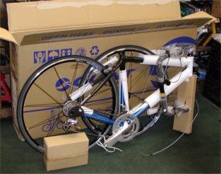

In general all your doing is duplicating how a bike is shipped in a box from the factory, if you can get an actual bike box it will make your life easier, heavy blankets work well for protection but cardboard and foam is good too. Wrap exposed frame components with foam or cardboard and add bumpers where the hard stuff will hit the outside of the box, I usually use triple layers of cardboard in those locations.
Here's how the factory does it;
