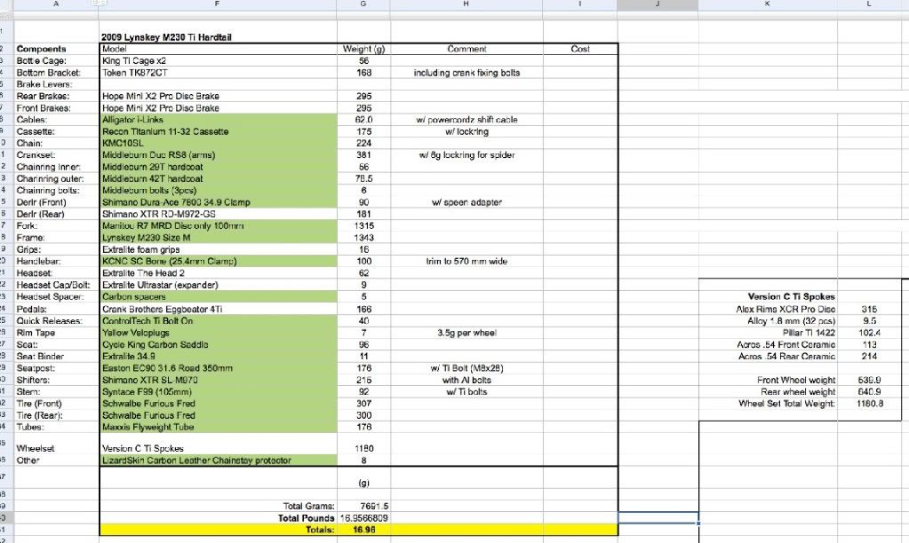

Ok fine... since so many have asked (including PMs), I was going to make it a surprise. Here is the parts spec. All items in Green I already purchased or have. What I don't have is brakes, pedals, headset, wheels. Also the items in green are real weights weighed on the table top scale.
Speaking of wheels, I'm open to suggestions. I can't find the Acros .54 Ceramic hubs anywhere. BTI is the distributor and they don't even stock the regular hubs. I want Jeremy over at Alchemy Bicycle Works to build my wheels this time, and he can't find the hubs anywhere. He used to be the Tune distributor for USA, but no longer is, so even getting Tune hubs is difficult. My backup plan is Notubes ZTR Race. I'm 165 lbs (a little heavier with beer and x-mas gatherings, and the trails I ride are literally groomed XC race courses only).
