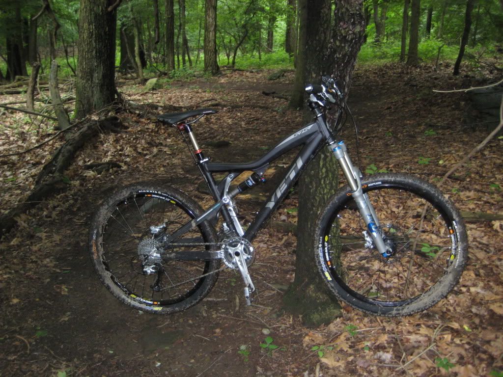

Don't hate....but there was a deal I couldn't pass up - Like $1000 off msrp at the local bike shop. I jumped at it....it has deore shifters but whatev'....the bike's clean!
I wanted to share and thought you all would be happy that I wouldn't be asking so many questions...for atleast a few days!

I'm certainly no clyde, but I was on the same quest a few months ago - to add a 5.5-6" FS bike to the quiver. I ended up building this for less than the "enduro" build MSRP:
Jenson has 2008 leftover frames for the bigger guy for a seemingly good price:
https://www.jensonusa.com/store/product/FR301B02-Yeti+575+Alloy+Frame+08.aspx
