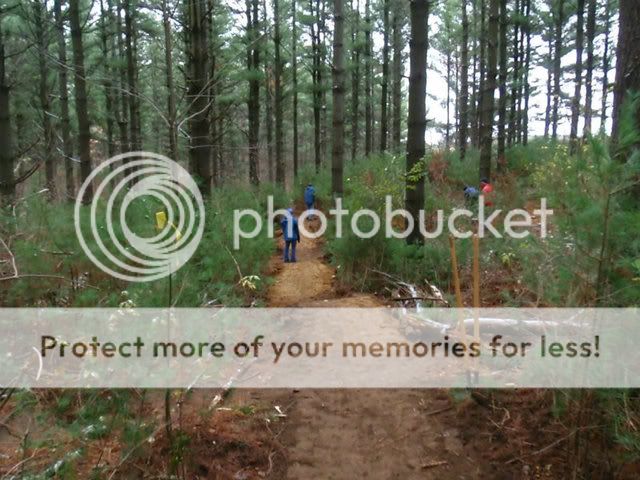

enjoy the thread,, log ramps. log overs I think are a tradition in mtbking... every year we get blow downs, those dang trees seem to know how to fall on the trail....if they interrupt things too much, we cut them out, but every so often one drops in a spot that 3 feet of quick elevation change really adds to the trail experience.
I've found keeping the stacking log sections about 5 to 6 feet long and 8-15 inch in diameter provides a nice solid stack that won't get wobbly on you, packing in some clay helps , something we have a lot of... they have lasted 5 years at least...
we are laying out about 4 miles of new trail and I am always on the lookout to include deadfall features if they are still in their prime.
I do like logs just laying across the trail, no ramps, but depending on speed/corners ramps might be the best option.
