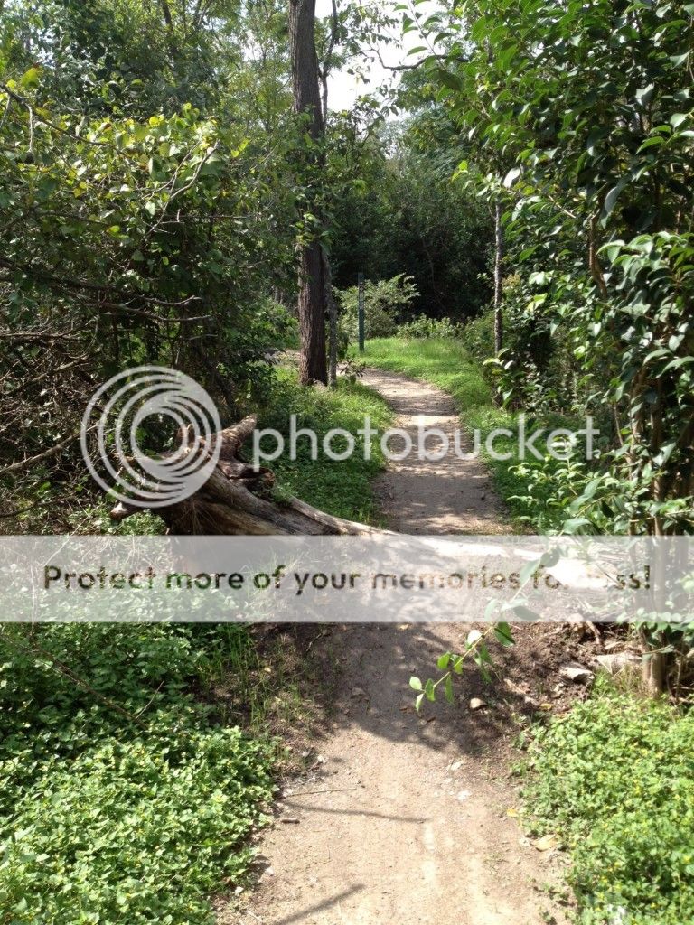

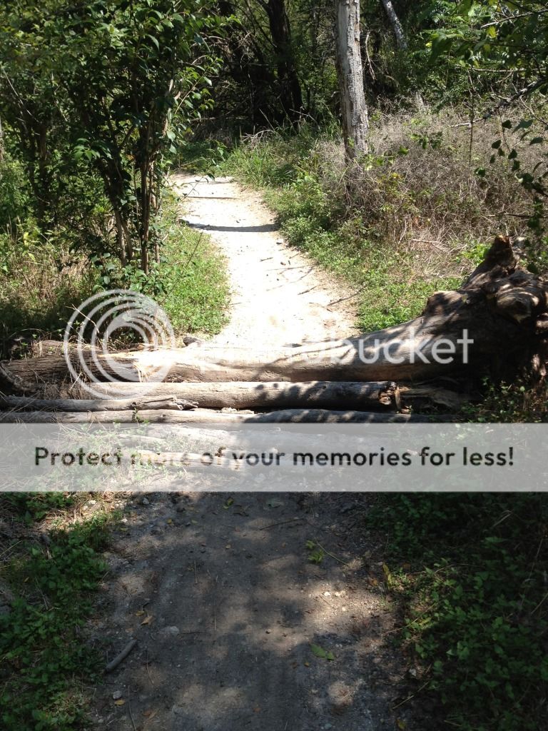

I'm interested both in opinions about whether ramping up to an existing fallen log is good or bad...and if "good," then I'm exploring bombproof ways to build these ramps so they last.
