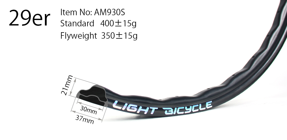

I’m seriously considering a new wheelset from Light Bicycle. I was hoping to get some feedback from users. (It is difficult to search for “Light Bicycle” with any specification here.)
Interested in the AM930S rim, 32 hole, with DT240 hubs and Sapim D-light spokes.
I’m under the impression this rim model is new, so just casting a net with the possibility that someone here has used it. It seems to check the boxes for a wide, but lower weight asymetrical rim.

Doesn't appear 'new' to me. It's not asym, 18mm lower height or have wide beads to combat pinch flats.
You may want to look at BTLOS as a comparable wheel build.

Thanks eb1888, but that link is actually a different rim altogether. The one I’m interested in is the 930S. With an “S” at the end. I can see where that may be confusing.
Though BTLOS seems like a good option as well, they don’t offer any hubs I’m interested in with the size I need.

Yes, thanks. They do, of course, scream “new”. I guess new isn’t always better.

I would get those rims because they are wavy. Look at that fancy wave!
I view Light Bicycle as a "do I want to try carbon?" company. Their warranty sucks -> at your expense you ship back a wheel. For maybe a 10% discount on a new rim (shipping eats away at all that immediately). I ordered 6 rims from them. One failed in what looks like a manufacturing defect. The other 4 have been fine. But, no feedback on that specific rim.

Still, this rim model seems fairly new so I was hoping for some beta. I may just push the button regardless.

I have also purchased several sets of rims from Light, though not the AM930S, and they have been great to work with all around. Quick to reply to questions, shipped on time, and all have come in exactly as spec'd. I haven't had to deal with any warranty issues so no feedback there.
